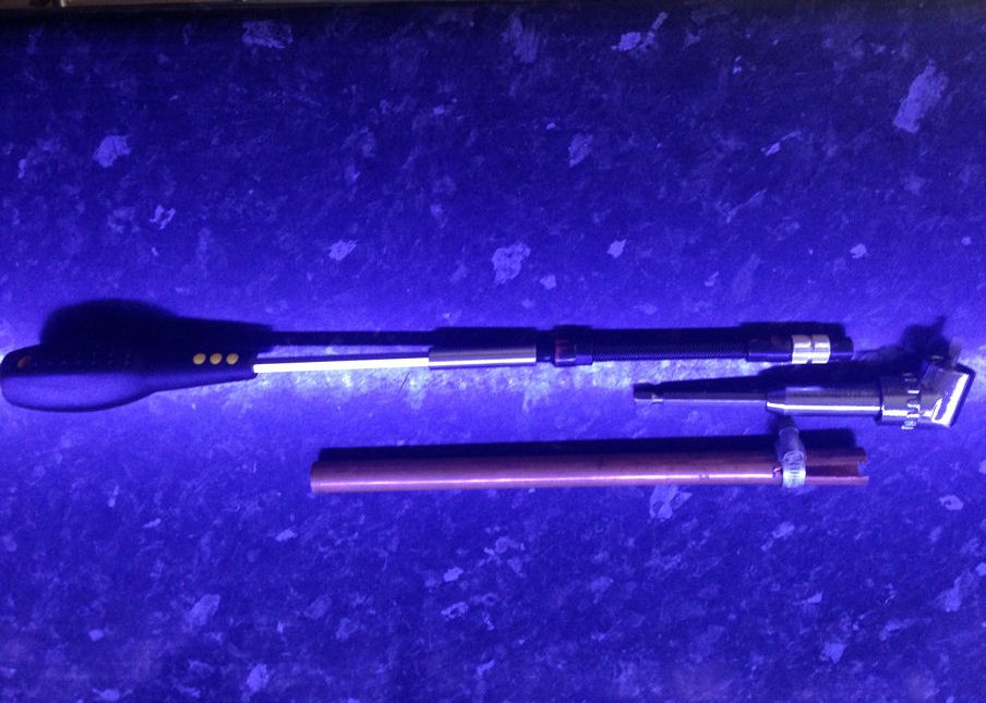

  12. Keith Inglis
    Keith Inglis Member
    Feb 17, 2015
    19
    Kings Lynn
    Yep done that Ram33 but it made no differance I am affraid, I think I will have to play ariund with the mixtures and see what happens but they are a pig to get to without the special right angle screwdriver, the only other thing I thought and someone suggested is a sticky valve ? because it only happens every four to five seconds running at 1000rpm,
    I do not know how long the bike has been standing, but going by the rear calliper in which the pistons are solid and will not move even with an air line or grips resulting in me having to order a second hand one, I would thing quite a while.
    Keith
  13. ram33
    ram33 New Member
    Oct 21, 2013
    4
  14. Keith Inglis
    Keith Inglis Member
    Feb 17, 2015
    19
    Kings Lynn
    Oh thanks for that Ram I have ordered one, when I re set the mixtures yesterday I was able to do the two outside carbs just, but I could not do the middle one and ended up taking the carbs off to alter the mixture, not something I wanted to do, this tool should do nicely :)
    Keith
