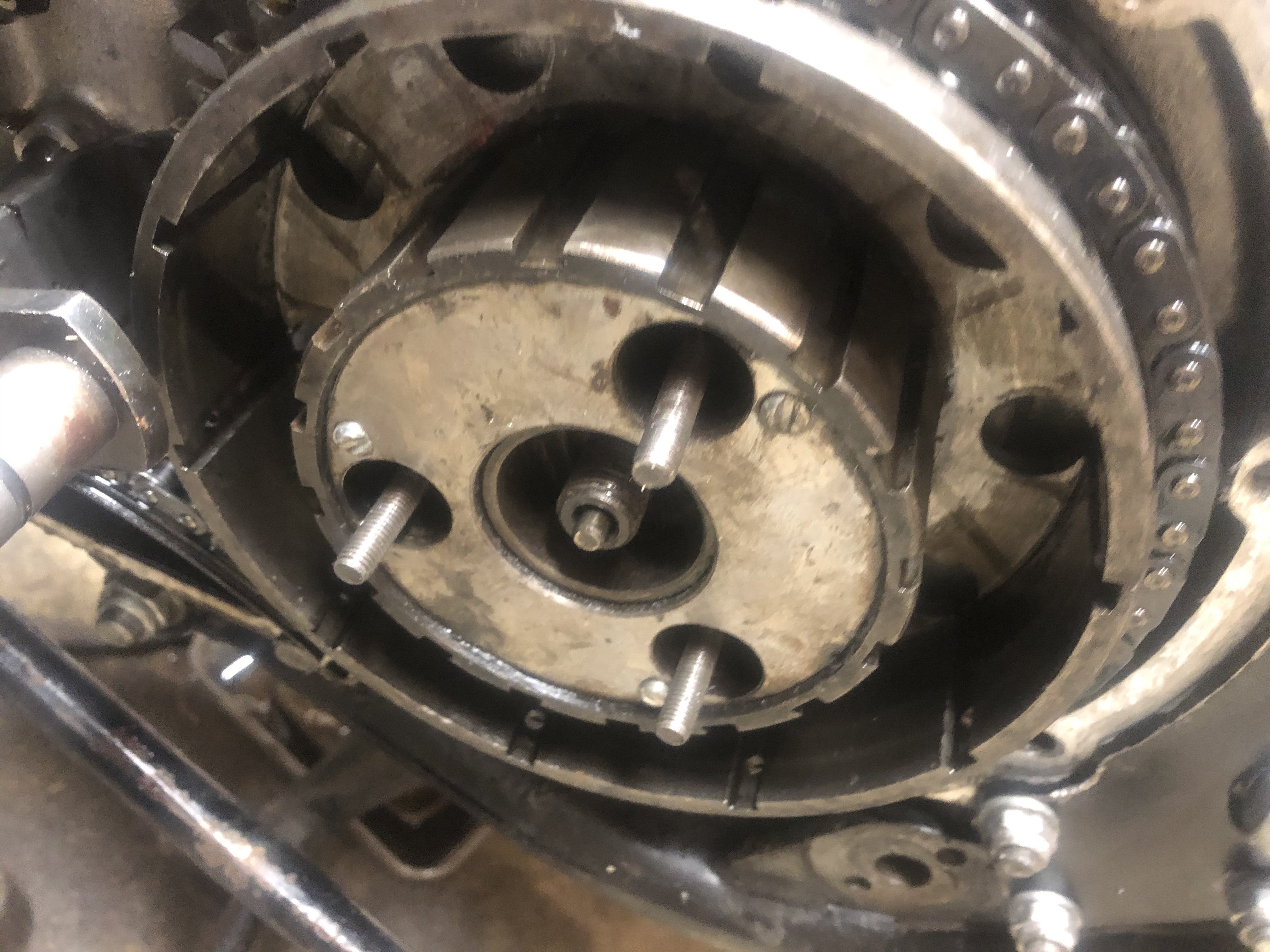

    I don’t know the history of my bike(1977 T140) at all it was very beat up when I got it and not running so I’ve been stripping down and I’m at the stage where I still have the barrel on and just the crank shaft pinion ( in need of the special puller) still on. This is the first bike I’ve ever stripped apart from a couple of 2 strokes decades ago that I took the barrels off so I’m a bit green on what is acceptable wear. Up to now I haven’t found any scoring or shafts and bushes that have any play but the clutch basket and centre shock absorber slots seem bumpy as in little tiny waves where the plate tabs engage with them. I can’t seem to find any info on what is acceptable wear. Any help appreciated
    Thanks Jim
  2. Jim Hargreaves
    Jim Hargreaves Well-Known Member
    A few photos

    Doesn't sound too bad it's the damper rubbers that wear and then the plates start to get hammered and the slots can get worn I have seen the basket slots really notched and the ends of the plate tabs really bad, if minor you can dress with a file.

    Yours look pretty good in comparison to some I've had. You can file them down a bit to remove the lips. Check the clutch plates as well as they can get lips on the tabs and can stick. A right pain in traffic as you need to get into neutral every time you stop as it'll want to creep forward even with the clutch lever pulled right in. Eventually the only cure is a new clutch basket, but yours looks fine. You'll tell when you are riding it.
