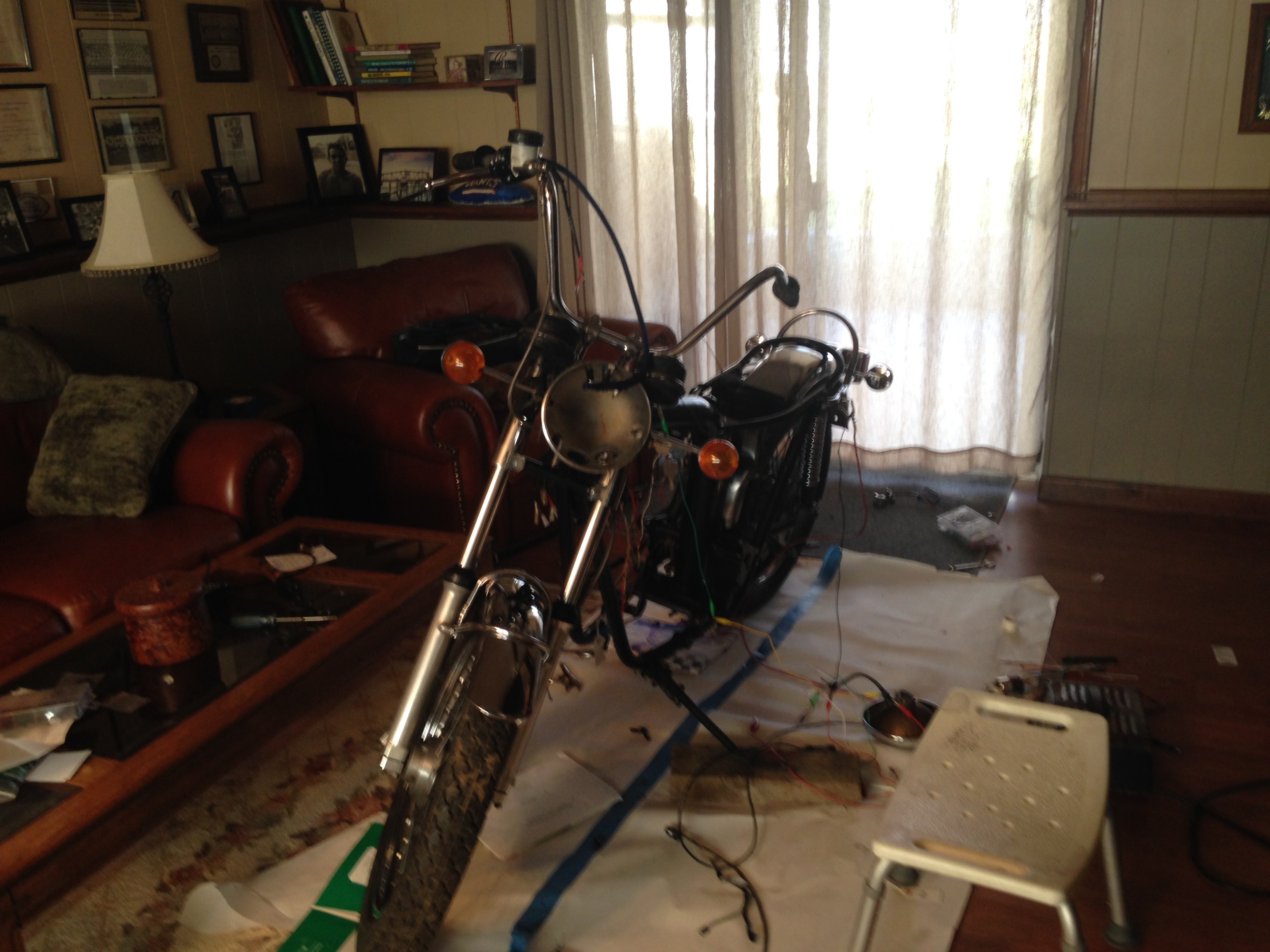

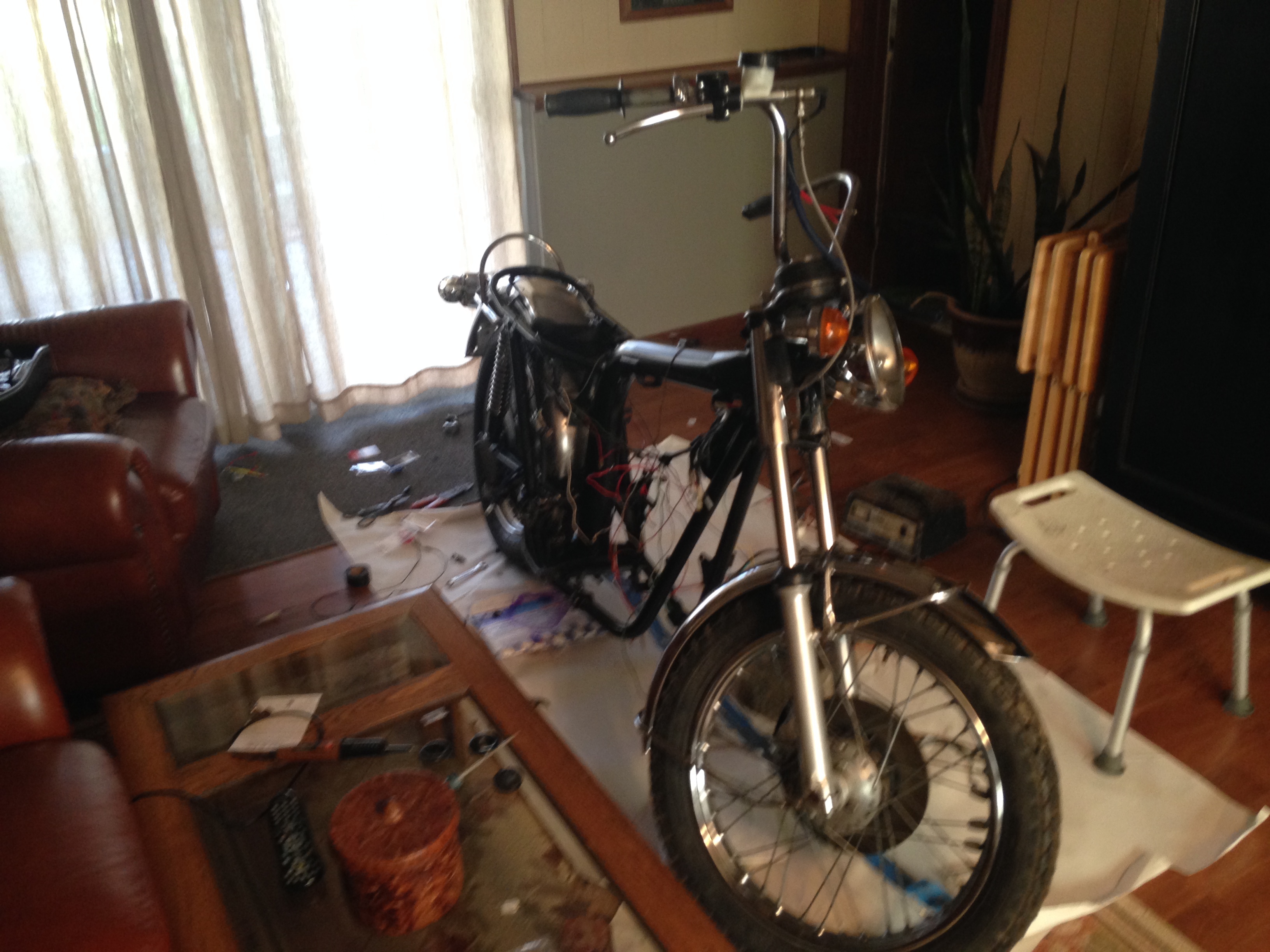

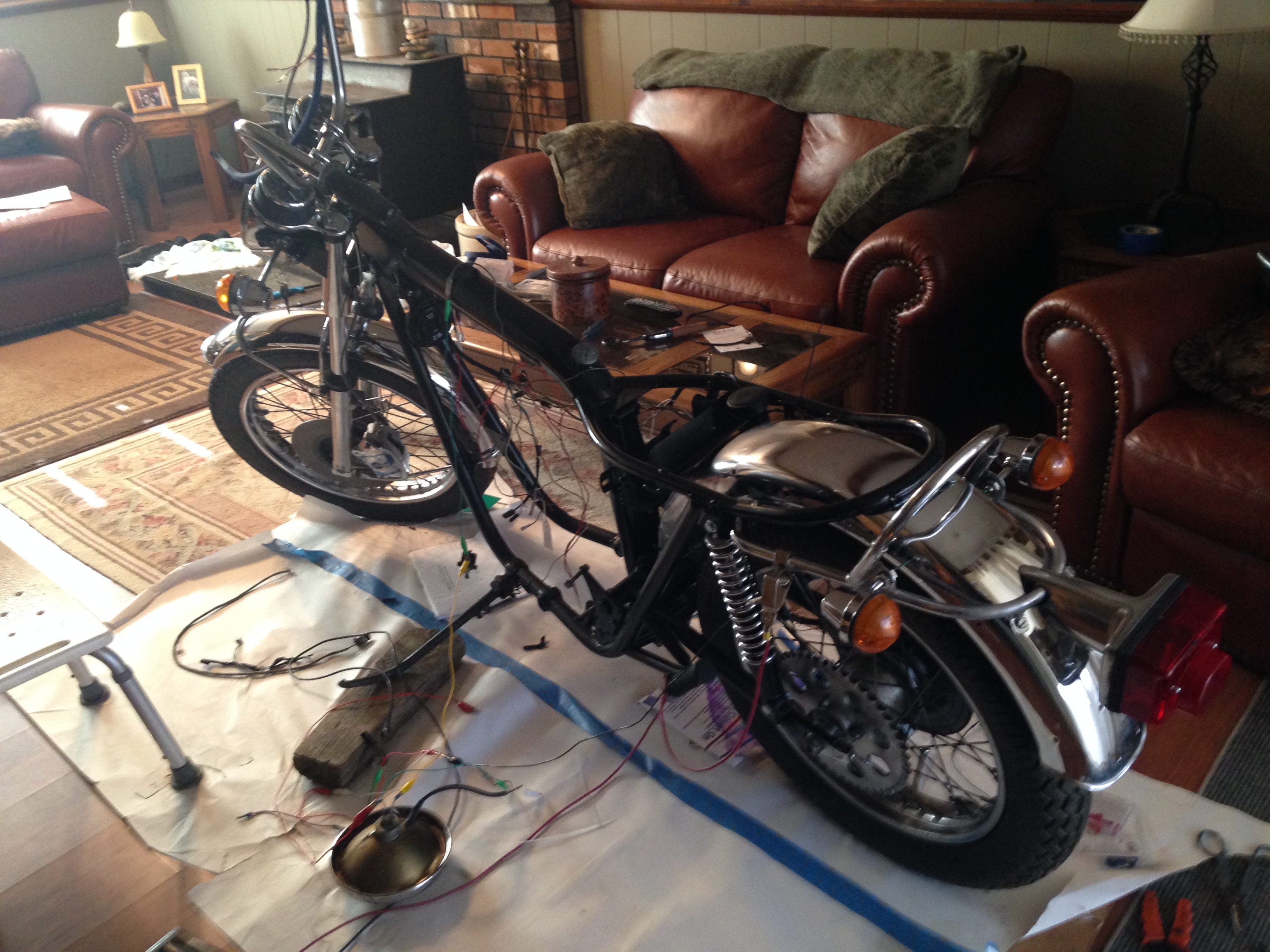

  11. Dennis Schermerhorn
    Dennis Schermerhorn Well-Known Member
    Nov 26, 2018
    83
    Connecticut
    It's starting to look like a bike. Still waiting for the jugs and head to come back from the machinist, but using the time to do some painting and to try and figure out electricity and wiring ...Brake,taillights, and flashers working, yippie!
