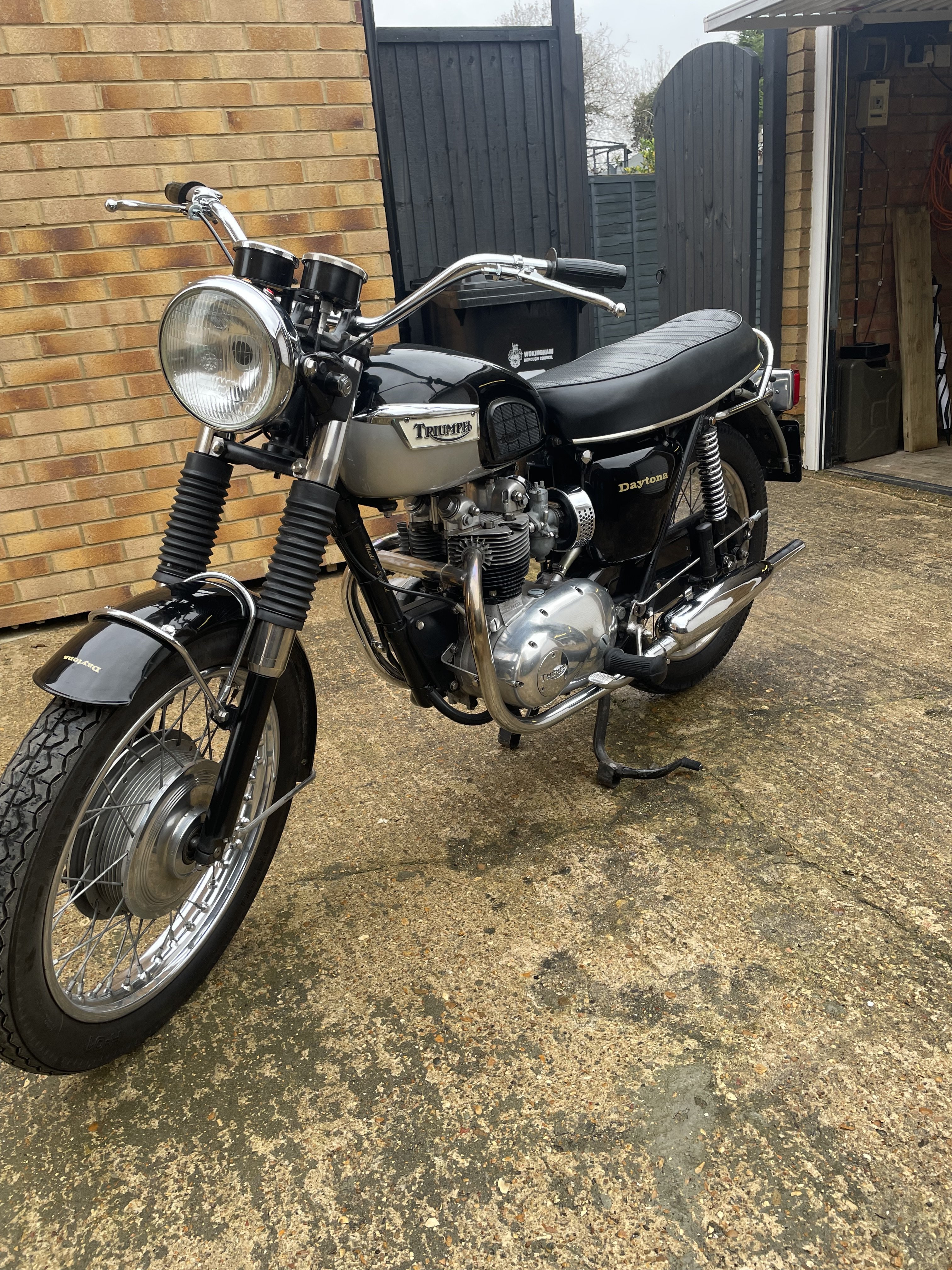

    Hi all
    In the process of getting above bike back on the road
    Before it went on display a few years ago I believe that they over tightened the oil pressure switch and cracked the timing cover
    I’m sending cover off for repair/ welding to a guy who only deals with old triumphs in Coventry
    I’m a complete novice to the triumph world and wondered if there’s anyone around the reading area who could come over and help/show me how to re do timing and points once I get cover back,
    Happy to pay/ supply tea, beer for a little help
    I have a haynes manual and a owners handbook but want a experienced triumph person if possible to show me
    Or recommend a good triumph man nr reading
    Thanks

    @graham kemp What a cracking bike. In the past i always put my Bonnies on top dead centre then marked all the points with a scribe. Then put it back the way i took it out. But there are a few very knowledgeable chaps on here if you get stuck. Myself i have help from them a couple of times at least. Good luck with the bike. I also think the covers are still available.

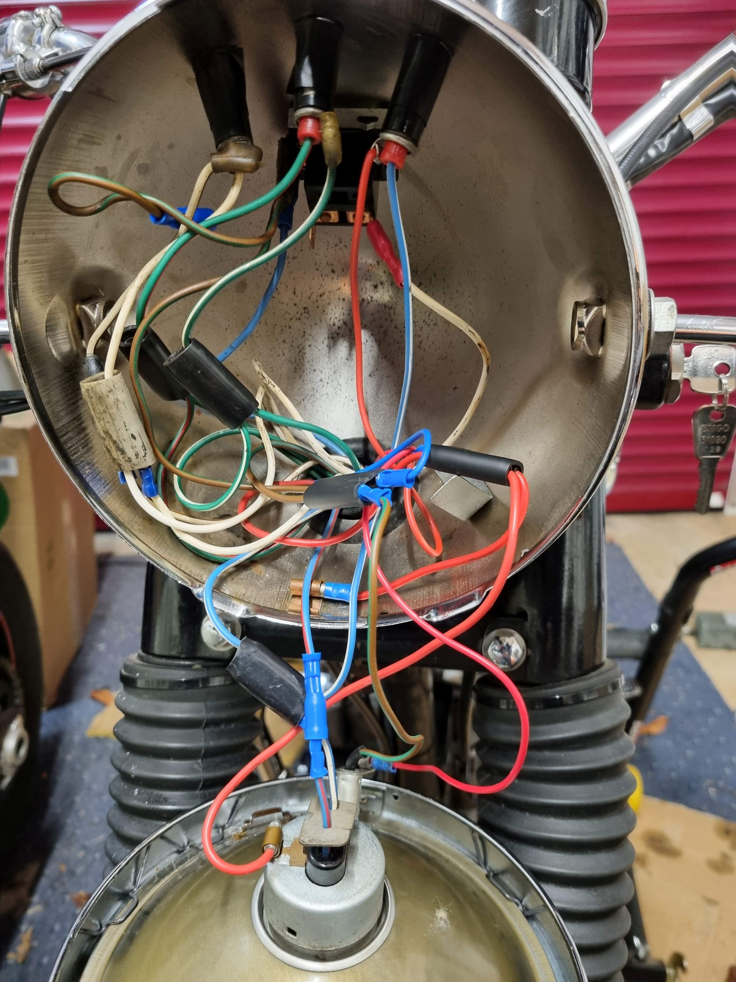

    Ok a update so far ,
    Got timing case cover sorted and a new straight oil pressure switch all on
    Managed to redo timing, brought myself a timing tool that locked engine at 38 degrees
    New problem is the electrical side
    I have rear light and brake light
    No headlight, rev counter or speedo lights
    I’m thinking of wiring up just a headlight on its own? So I can safely ride it for the time being until i sort out the electrical side if anyone can give me a idea of how to please ( the rear light comes on and off on the light switch on top of the headlight)
    Maybe somehow linking it up with the back light?
    I’m pretty useless when it comes to electrical side
    Opened up headlight and total mess, someone has obviously had a go at it before

    I'm not a wiring guru (not so much a black art to me, more like a black hole!), but the headlight should always come on with the rear light (and yes, via the headlamp switch). I attach a pic of my '72 headlamp wiring if that helps at all (probably not).
    As to tickover, Daytonas were never known for great tickover, but if she's been standing for some time it wouldn't hurt to clean the jets. Particularly the pilot that governs tickover. My '72 never needs choke unless its VERY cold outside, and ticks over after a minute of warming up (although every bike is different). I re-used the carb gaskets and they don't leak, but new ones are recommended of course!!
    I have a leak or two from the rocker covers (and other places!!) so likely yours does too, running forwards over the exhaust clamp.
    Triumphs ARE noisey beasts!
    I have the same speedo issue as you. I found the speedo cable was actually rusted solid near the rear wheel and so replaced the cable - the needle still jumps all over he place, so I guess the speedo is dirty inside. Mine is an import from California so my guess was that it may have dust/sand inside it. But I am not capable to take it apart to find out!!

    th
    thanks for the pic, unfortunately the colours don't match with mine
