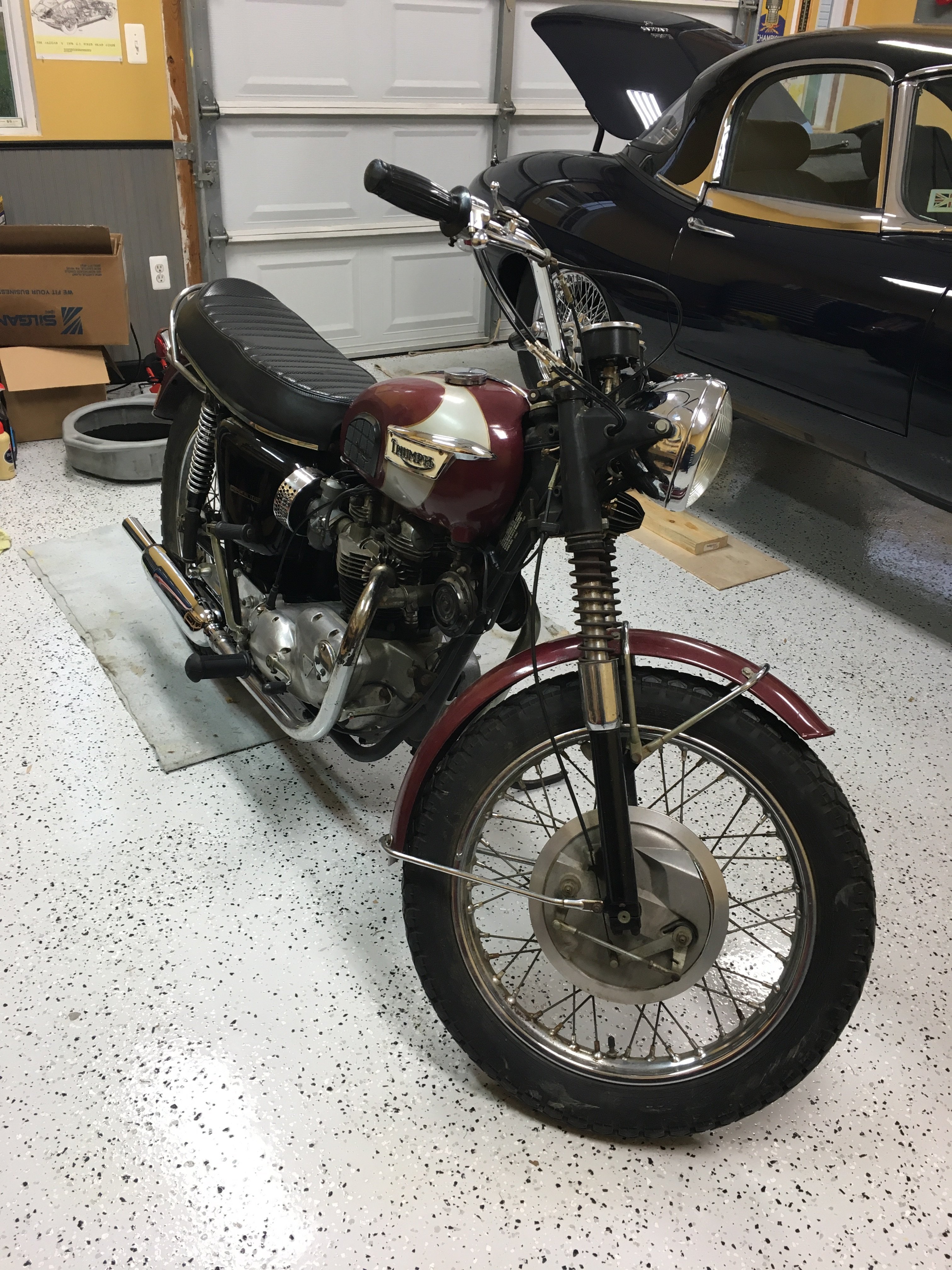

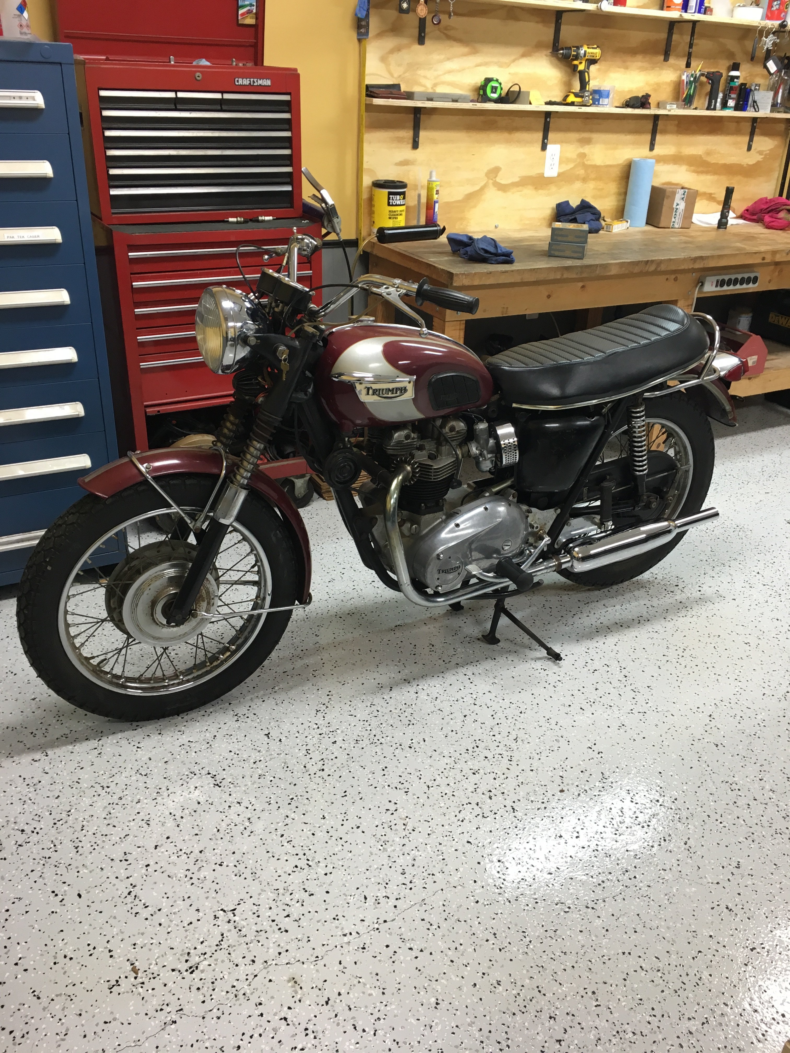

    Hello,
    I posted early last year about a 1970 Bonneville I purchased. Finally had some time to work on it to prepare it for the spring : new chain, tires, inner tubes, points/condenser, rebuilt carbs, new mufflers, etc.......I drained the fork fluids and got some water. I know they take 200 cc each but can't find what kind of fluid.
    Also, I would like to inspect the front brake pads and there is a 1-1/8" nut on the shaft. I believe I read its left hand thread . Is this correct ?
    Thank you in advance.
    Mark
  2. darkman
    7,658
    Hi Mark, 190cc is the correct amount of oil for the forks and 20 or 30 fork oil will be fine. The nut retaining the back plate is right hand thread.
