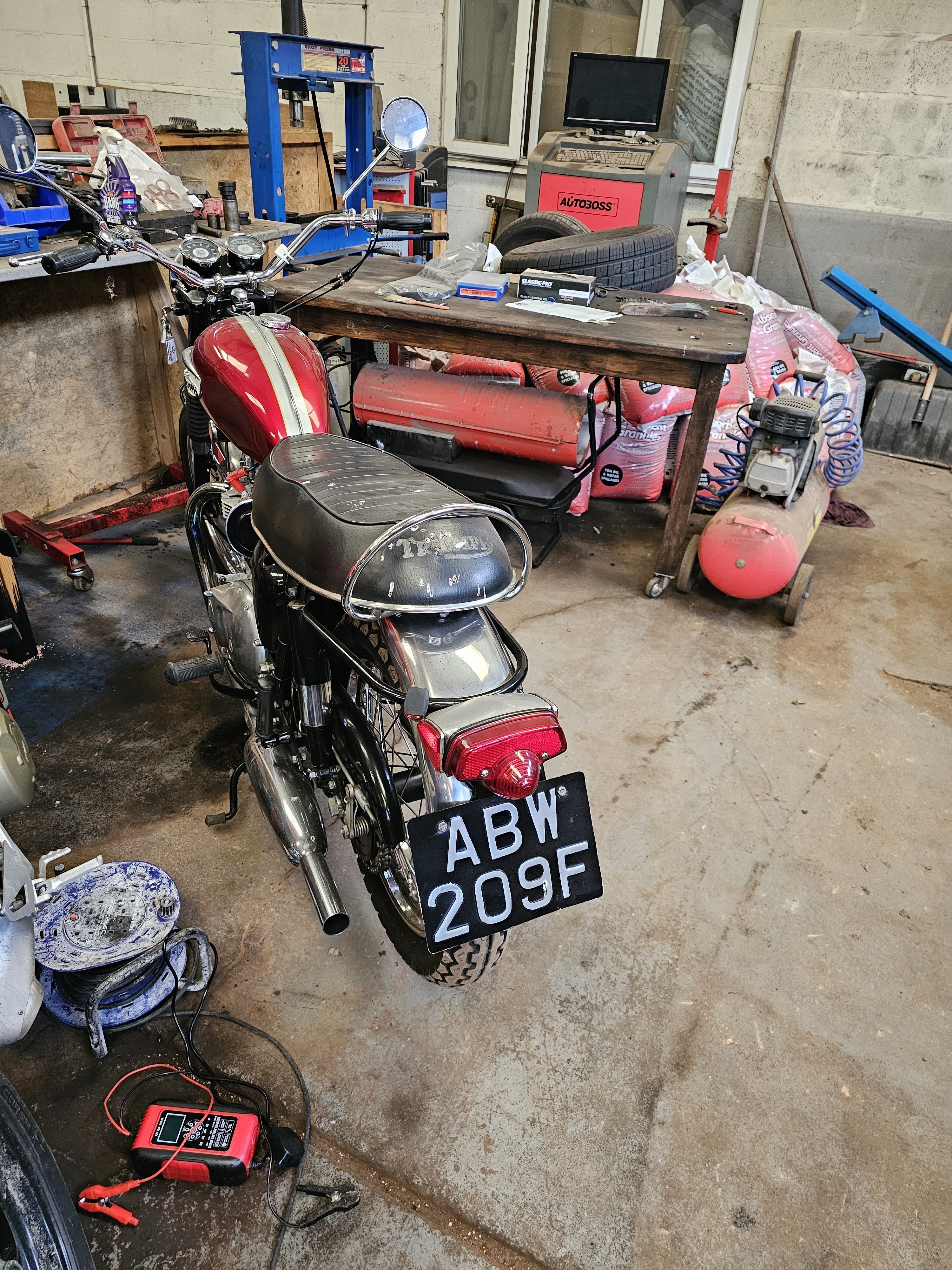

    Hi all, I'm new here so will be nice to chat to some of you.

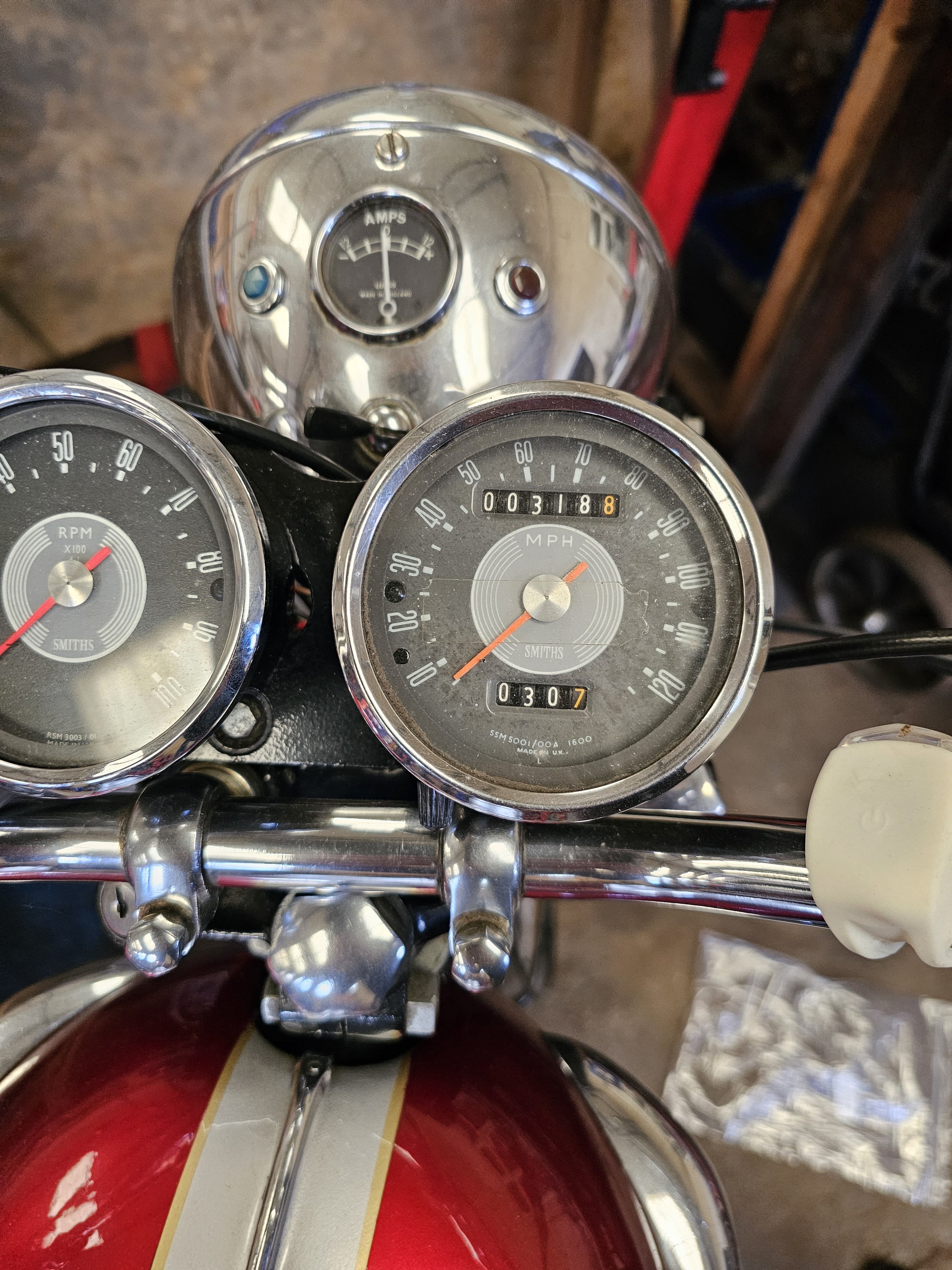

    I have inherited a 1968 bonneville and really I'm looking to gain some more knowledge on it and of course it's value as it appears to apparently be rare. I'm a bigger modern bike guy but I never was into my classics unlike him, I should have paid more attention!. She runs fantastic and only has 300 miles from new but I doubt I'll get more than the 1 run I've had as the weather's now setting In. I've attached a pic if anyone can help please on detail etc

    thanks. I have the mot history back to 2010 and it was on 2 miles then. i also have the heritage clubs certificate but noting else unfortunately

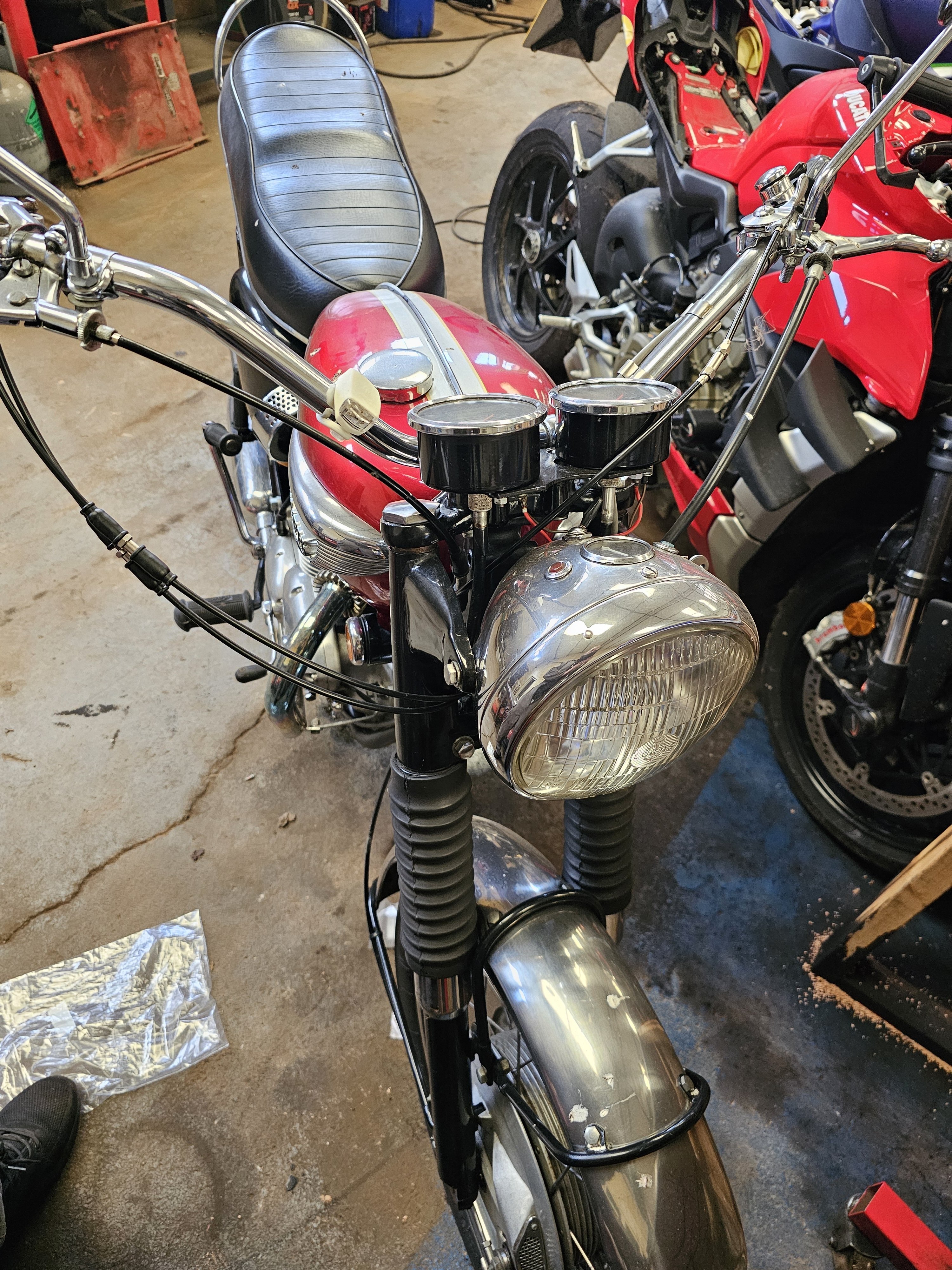

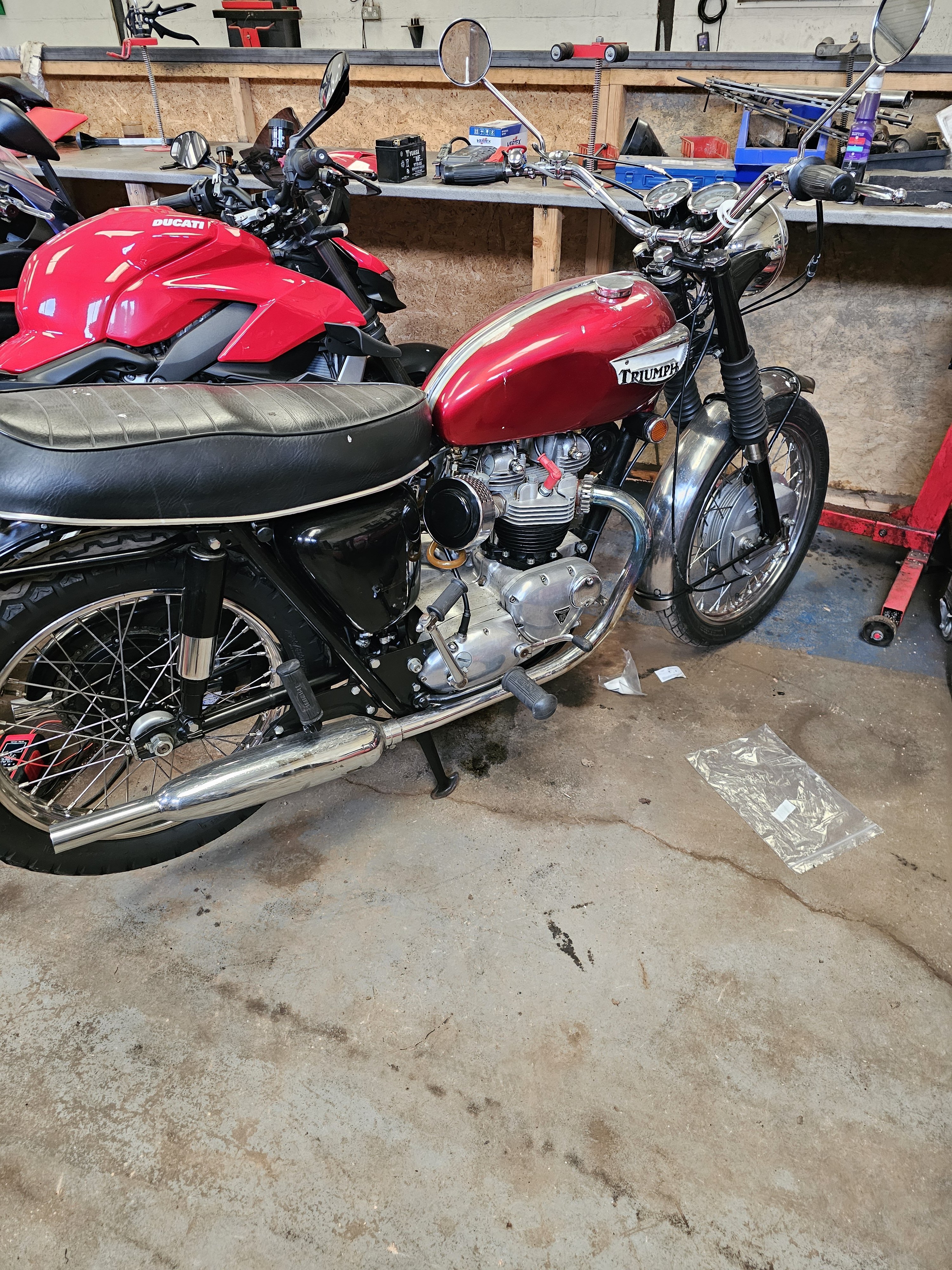

    That is a nice motorcycle in fine condition. As it's an "inheritance" I hope that offering condolences is in order. In terms of the bike, I hope you don't mind me offering some observations?
    The bike is, clearly, an export model - probably North America if the "peanut" tank and high bars are any real indication, but I have considerable doubt that the 318 miles 'total' is quite as straightforward as it might, at first, seem to be. Why? Well, there are a few clues to a, presumably, 'hidden' past :-
    • the plug cap visible isn't factory original. I THINK in 1968 it would have been Champion (maybe Lodge?)
    • the engine case cover screws have been replaced with allen (socket head) type screws - factory original would have been cross head
    • I'm really not sure about the mudguards - the fact that they're alloy blade rather than factory painted could, again, be an export market thing but I would expect "home model" to be colour painted
    • the rear light is export model spec.
    • the under tank reflectors are, for that era, export model spec.
    • the air filter pod backplates should be smooth without the 'raised' centre part
    The V5 document (and I agree, it would be wise to remove that picture if you can) shows date of first registration in 2010 so that, I imagine, is probably when it was repatriated/imported.
    Regardless of all my apparent 'nitpicking', I think it's a great bike and, if it goes as well as it looks, it will be a wonderful machine to ride and enjoy and I hope it gives you many miles and years of pleasurable ownership. ENJOY!

    Champion WC548's are the correct plug caps, there are repro's available online and if you spend a little time even the originals can still be found. Congrats on the bike and enjoy.
