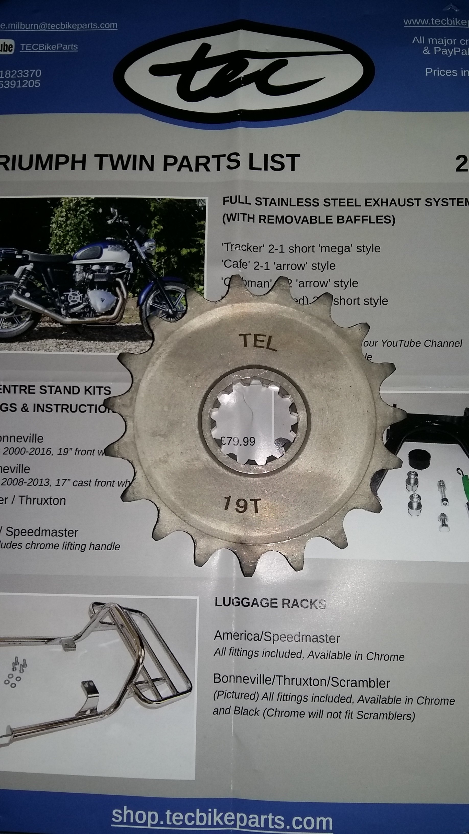

    Just got this from TEC.
    Had one on my T100 - reduces revs by around 300rpm, better for cruising at motorway speeds.
    Will be fitted this weekend.

  3. thebiglad
    5,072
    I had a 19T on my T100 as well. As Steve says you lose about 300rpm for a given speed plus the speedo (if it's a gearbox driven one) reads absolutely spot-on accurate, instead of being a bit 'optimistic'.

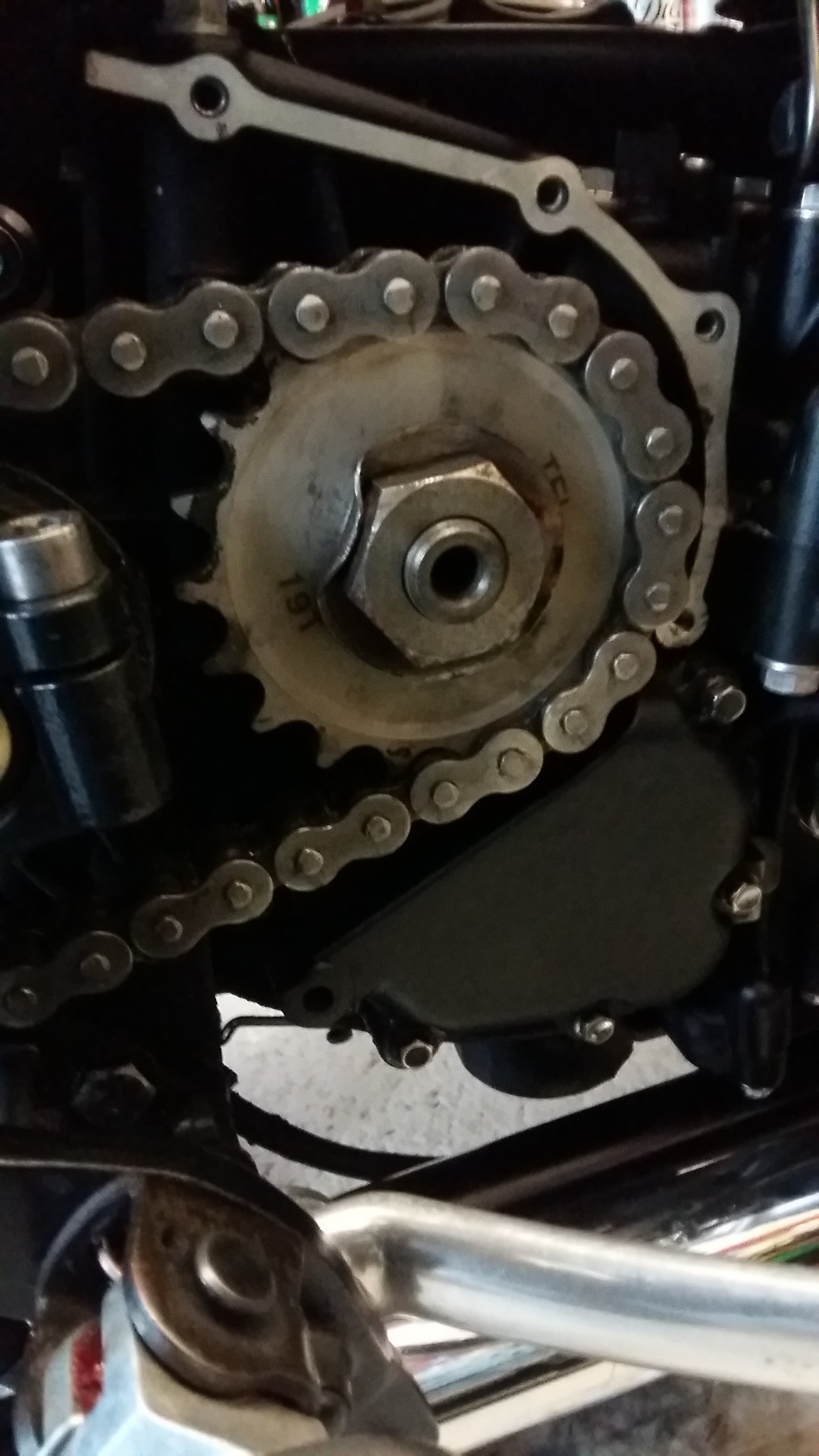

  9. steve lovatt
    All done.
    Easy job but you will need a 36mm socket.
    Bend back the washer to remove the nut and remember to bend it back in place when you refit the new sprocket.
    Here's the new 19 tooth on.
    Hopefully road test tomorrow !

  13. capt
    capt Elite Member
    May 8, 2016
    3,051
    western Australia
    Hi Steve,
    I have changed chains and sprockets on my Triumphs, being 94 trident,00 sprint and 08 America, all had 36mm nut on the front sprocket output shaft, me thinks I see a commonality here and some forward planning by Triumph !!
    I'm thinking this might be common on all chain driven Triumph motorcycle's ?

  14. steve lovatt
    No chance to test yesterday as we had freezing fog.
    Better today but roads still wet but went for it anyway.
    First impressions: The reduction in rpm is not as noticeable on the rev counter as it will be on the 790cc Bonnies because with them, the speedo is a cable drive off the front wheel. The later EFI bikes have a speed sensor off the gearbox so the change of sprocket does change the speedo reading - makes it accurate I believe. As such the visual difference is not very much - just can't quite match 70mph with 4000 rpm.
    Didn't feel as if it affected acceleration in the lower range at all but overall it did feel like it wasn't working quite as hard as before but I think I need to put a good few more miles on it yet to pass proper judgement.
