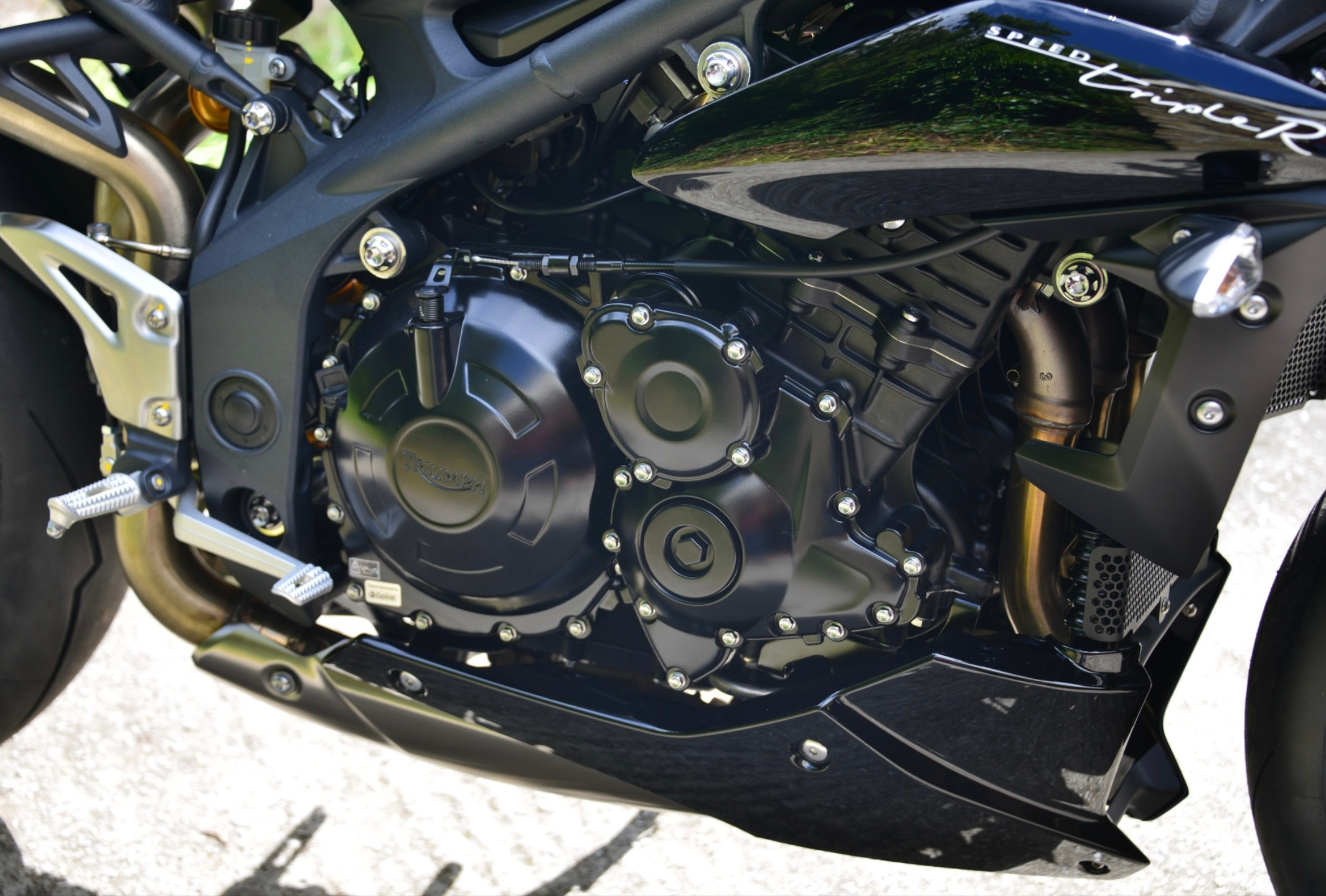

    Hey everyone, just got a quick question for you all. I have a '13 Speed Triple and I was wondering if the clutch cover that's on the '16+ Speed Triple will fit on my bike. The design is so much better imo and they look very similar in shape. Pictures attached for reference (neither bike is mine). First image should be the '13 and second one should be the '16+

    Look up the part numbers on fowlersparts.co.uk site. Will give you an idea

    Looking at the diagrams between the two, the part # for the covers are different BUT they do use the same gasket which means the bolt locations would be the same

    So it looks like the cover itself will fit but it might be worth checking the clutch actuator arm part numbers as I think there have been mods to the clutch over the years.

    Just did that. The covers do use different arms. I could have swore that I saw one for sale around my area recently that had the newer cover on it which is why I was curious if it fit.

    Did you perhaps see a 2015 bike? My 94R has a cover half way between the two but has the steel operating arm so I would think is more likely to be compatible.

    It might have been? I wish I would have saved the post. But yeah, that one looks like it might work better and still has a better design to it than mine. Appreciate the info!
