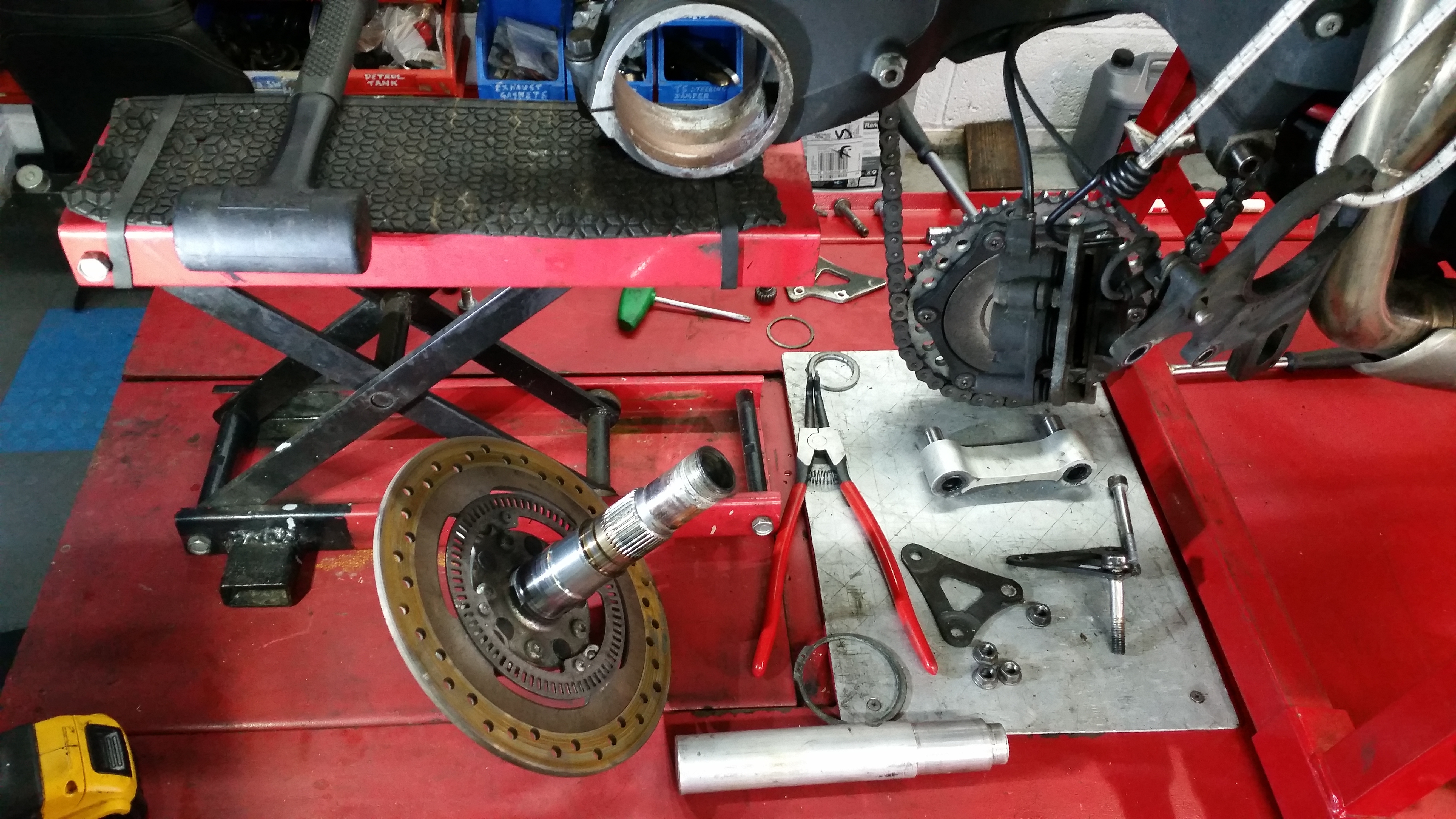

    No quite straightforward, I did find the bearings in good condition, but a lot dryer than expected.i would have like to see them smothered in grease.
    There's various ways to support the bike, used a front stand (get someone to hold front if you don't have one)
    Trolly Jack under drop link, the once jacked, axle stands under foot pegs.
    Also when the back wheels off the floor, support it underneath with a brick/wood, to stop it dropping when linkage removed.

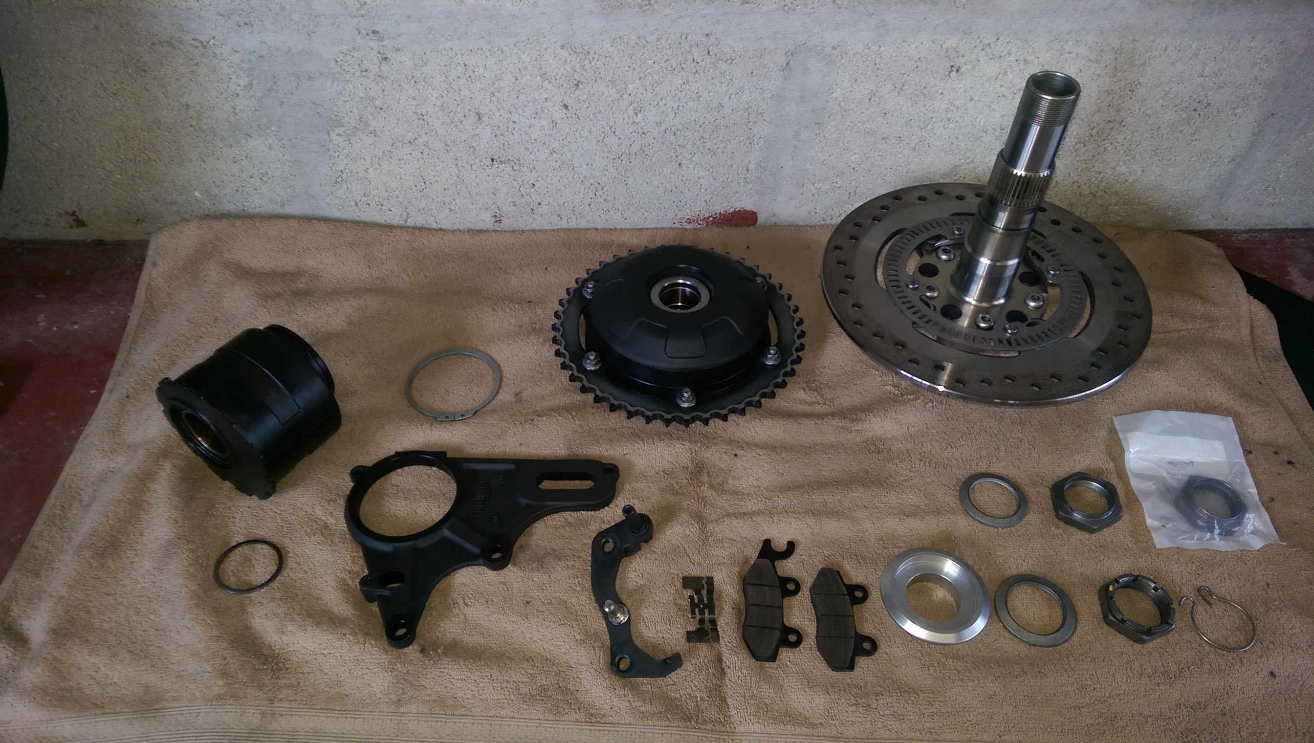

    If you've got an Abba stand or similar the job's a doddle, needle rollers are caged so not going to fly everywhere. As said mine where still full of clean grease and even the hub carrier was well coated in copper grease (must have been assembled by an enthusiastic operative at Hinckley:)).
    Ideally you should have a new nut ready for the sprocket carrier side, although you could probably get away with re-staking the existing (think it was nearly £20 for the new nut!).......which is an obvious way to tell if the dealer has looked at the hub.

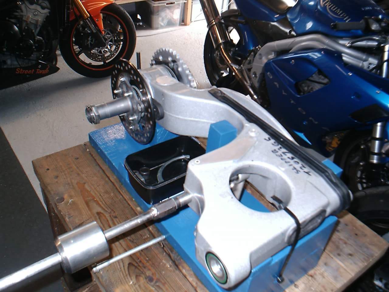

    Dependant on model, early ones idealy need a slide hammer to remove the top pin that holds the drop link. Will be a bugger without. Later ones are not so bad.
    This is Clive Wood's demonstrator for maintainable courses.
    If any bearings are gone. (almost certain) only fit full compliment bearings, not cheap caged ones (not fit for purpose).
    You will also need some big circlip plyers for the hub.
    If you don't
    Have the tools best see Clive for a top job!
    #18

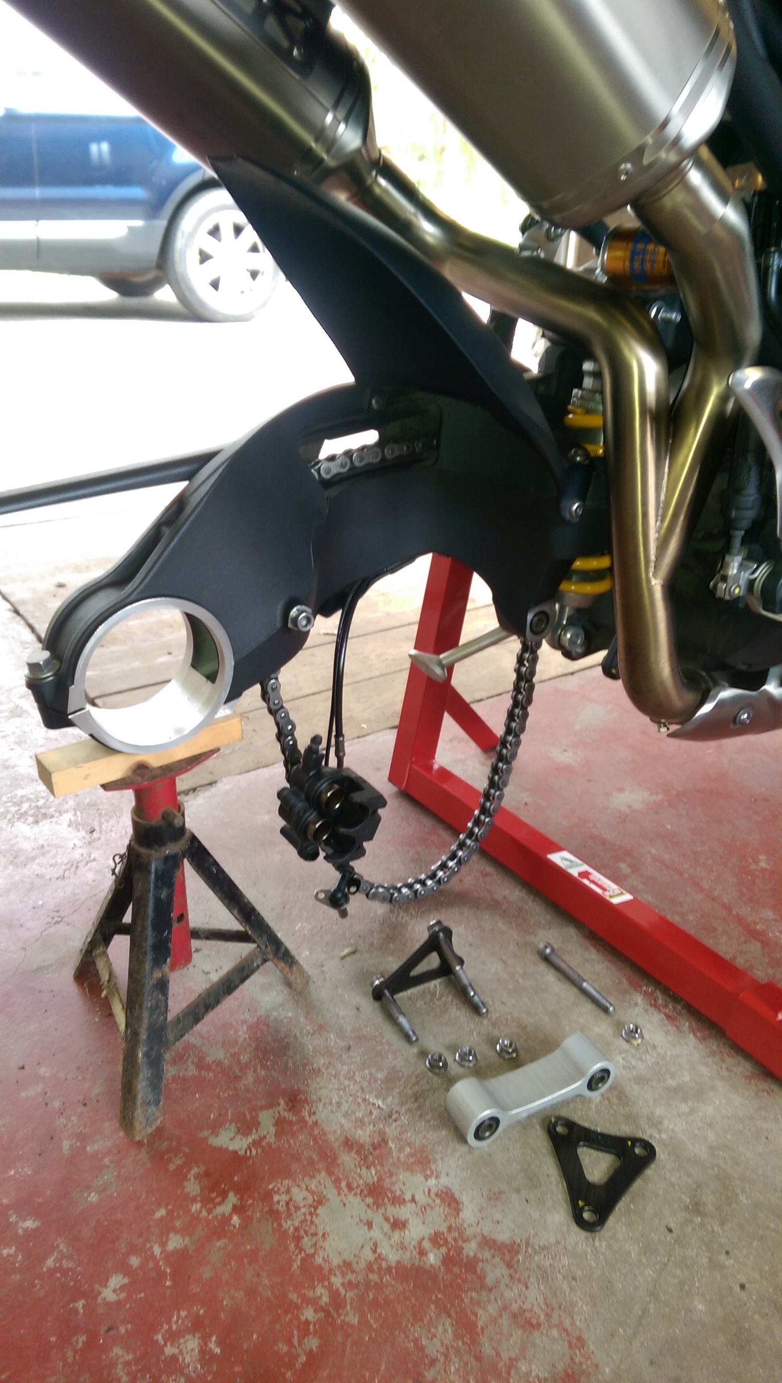

    Later type being worked on
