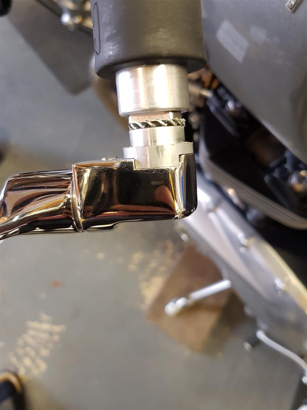

    I've purchased a pair of Halcyon 830 bar end mirrors (The old Stadium design) with T120 adaptors to fit my Thruxton R. The mirrors ooze quality and to my mind are a better match to the retro styling than the black and grey standard items.
    Fitting them made me realise though that I also need to purchase some bar-end finishers because in removing the Thruxton mirrors - which clamped round the bar ends - I now have an untidy result per the photo below.
    Can I assume that water cooled Bonnie finishers will fit my Thruxton bar-end inners?
    Cheers!
    CR
    (PS - those aren't scratches already on the brand new mirror; they are soft focus bubble wrap wisps!)

    Thanks, guys. I have tried insulating tape already and didn't like it, but brushed or chromed tubing is a good idea as I can fit a piece long enough to also cover the washer and inner section of the mirror bracket. :)

    For anyone else finding this thread and contemplating the same change of mirrors:
    • The outside diameter of the Thruxton R bar end is 22.23mm (7/8").
    • The outside diameter of the T120 bracket is slightly less - so a short stub of pipe pressed on to the bar end will cover the bracket with a tiny air gap all round the latter.
    • The distance from the end of each hand grip to the elbow on the T120 bracket is just over 22mm - so a length of pipe 21mm long will leave a small gap to ensure smooth throttle operation. Doing the same thing on the other side will keep things symmetrical even though of course there doesn't need to be a gap to the rubber grip.

    Back in 1976 my parents bought a Schreiber wardrobe for my bedroom. It served me for 18 years until I sold my first house in 1994 when weakened from a fair few assemblies and dis-assemblies, I took it to the tip - but kept the chrome plated brass pipe that constituted a shoe heel rest. Roll on a further 24 years and three house moves later when I remembered that the pipe was with my "it might be useful one day" bits and pieces.
    The result is as below. :)
    Excuse the polishing cloth fluff on the throttle grip but I am chuffed with the result. It needed just a couple of turns of insulating tape to make the chromed pipe a very snug fit so we'll see how it lasts. As you can see, there's a small gap around the bracket, but hopefully that will not matter.
