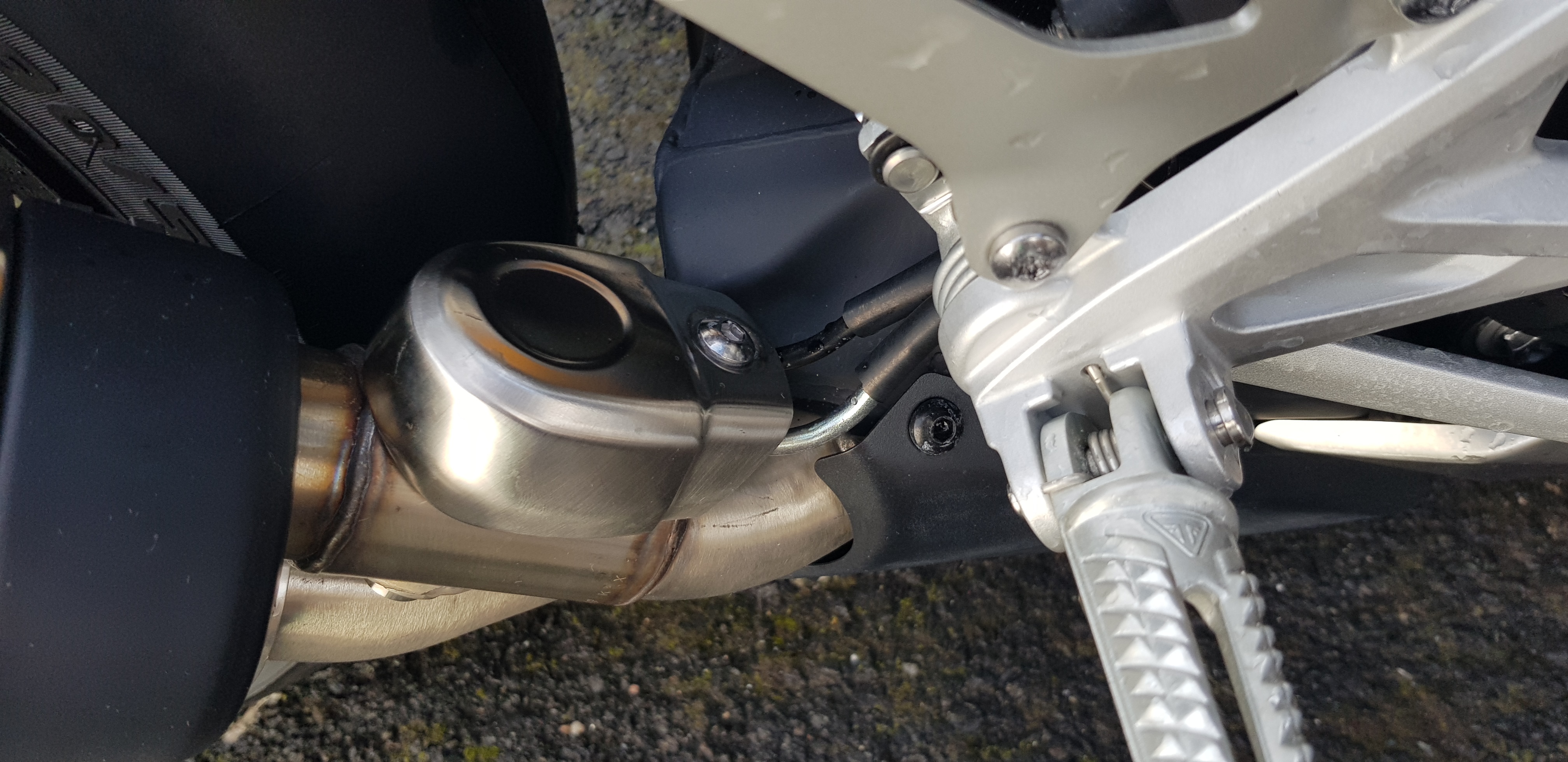

    So had my first warranty issue.
    Been checking the exhaust valve cover regularly after reports of it coming loose and falling off. On this occasion it seemed very loose and on inspection it was found that the bracket the cover bolts to had completely sheared off, and the cover was just sitting in place not attached to anything. Dunno how it stayed on. Any way dealer informed..looks like a complete new exhaust can as everything seems to be welded up around the valve. Pics for anyone interested.

    Exhaust valve's the devils work anyway, when the misses had a Daytona675 it was known to regularly seize and sometimes burn out the actuator. Better off ditching the bloody thing, think it was just there for noise regs on the 675 - is it there for that or mid-range boost on yours?
    What's the betting dealer blames your size 11 boot for the problem, looks too close to the footpeg in your photo.

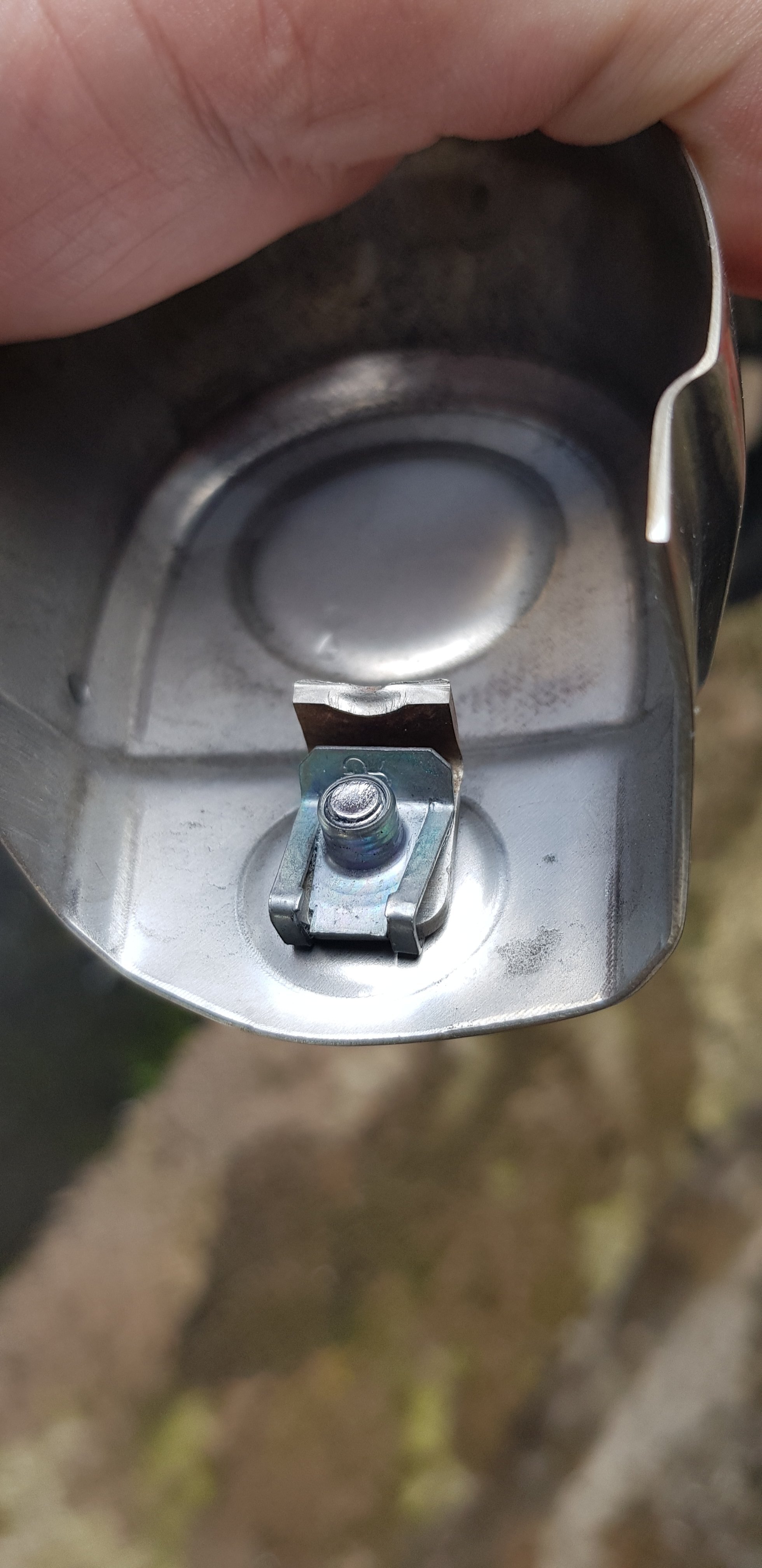

    I safety wired mine a few weeks ago. I think you're the first person to retain the failed part! Nice pic confirming the exact spot. Everyone's pics were difficult to tell exactly.

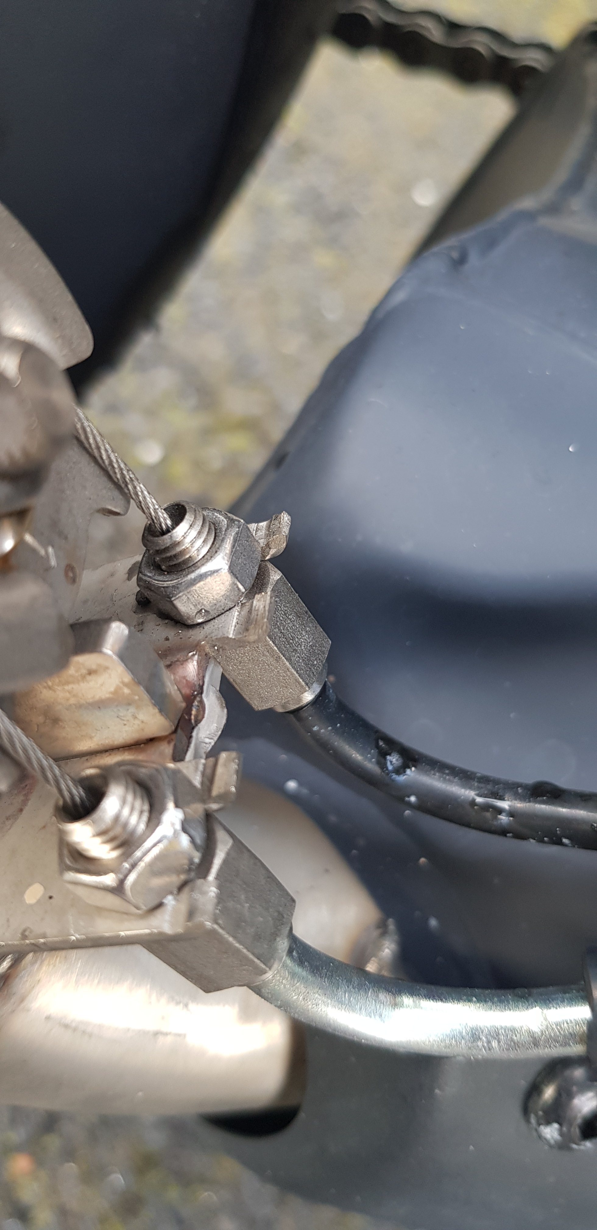

    So it seems Triumph have acknowledged the problem and have developed a retro fit bracket which attaches across the cable mount..my dealer called to inform me it will be at the dealership next week so all good....

    so this is the triumph dealer fix if anyone interested..
  14. Col_C
    Col_C I can't re...Member
    Aug 5, 2015
    1,433
    Mmmm, so the sort of bodge you'd knock up at home if you'd bought a used bike without a warranty. :confused:

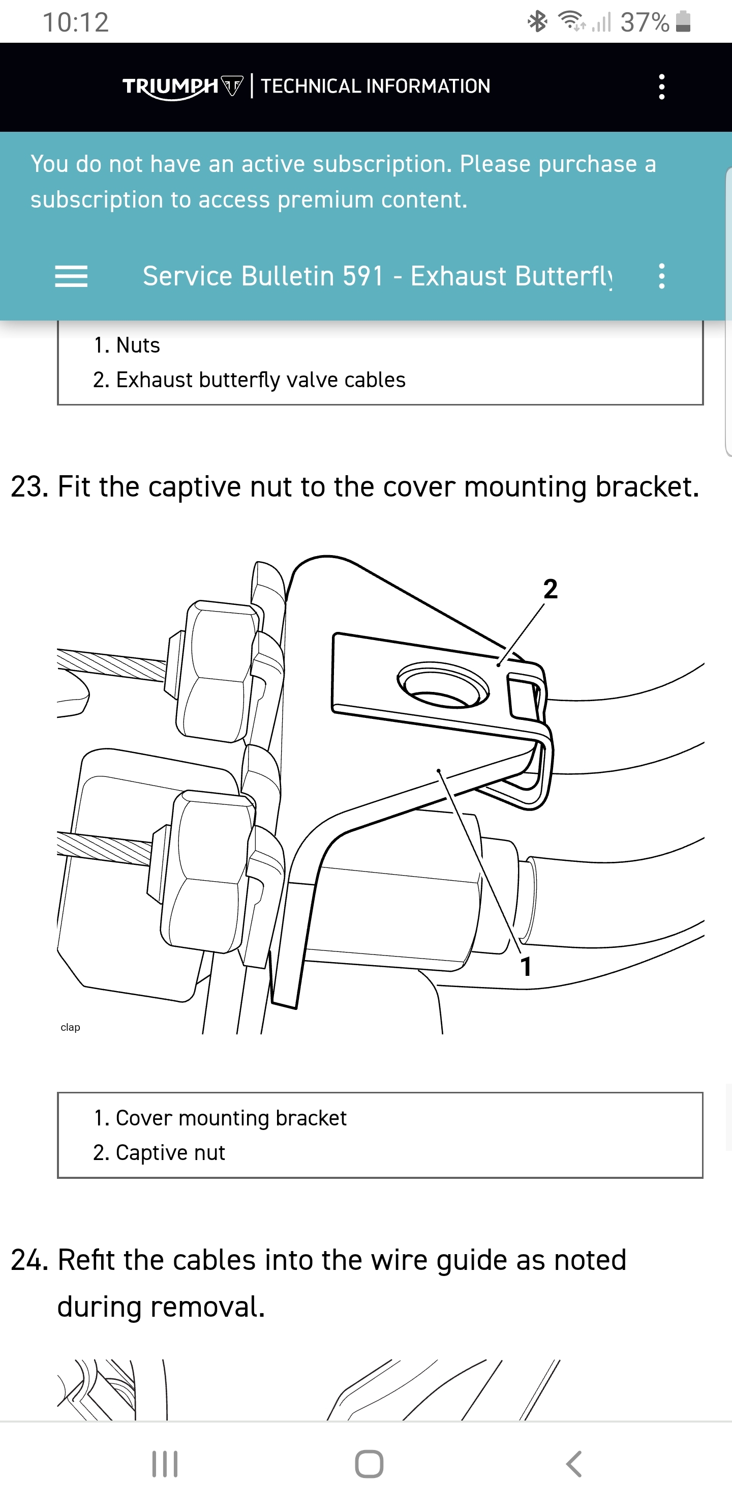

    According to Triumphs Technical Information website, their replacement for Tritun, service bulletin 591 instructs dealers to carry out this modification either prior to delivery or at the next visit to the dealership. The VIN range affected is from AD2117 to AU6999.
    Also Service Bulletin 590 instructs dealers to re-torque the alternator, clutch, crank and balancer cover fixings to 10Nm, again either prior to delivery or when next at the dealers. For those doing it themselves BE WARNED do not tighten the fixing partially hidden by the Crankshaft End Cover because this may cause damage which is not covered by any Triumph Warranty.
