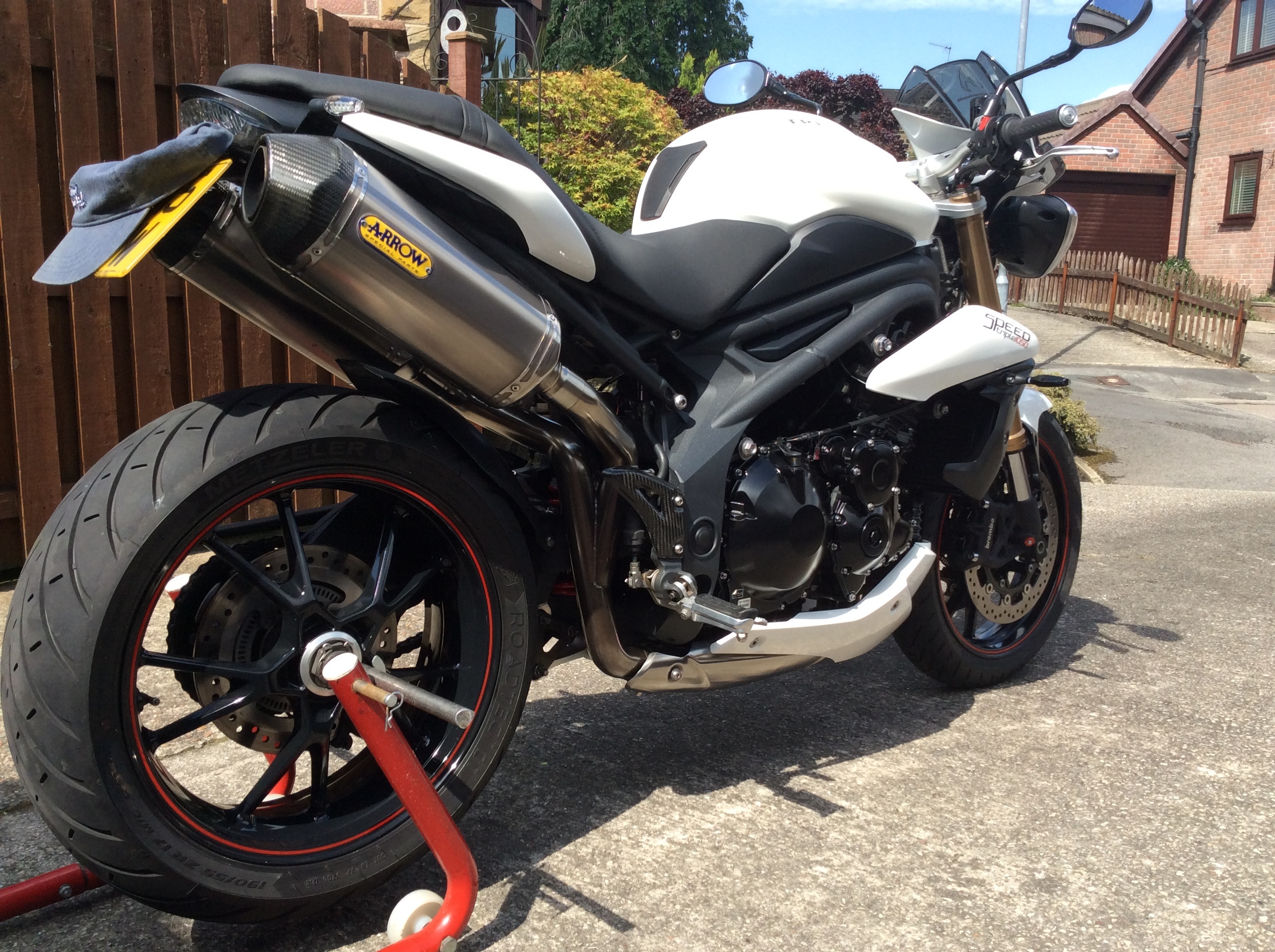

    23CF3CAE-745D-44F3-8FD5-A08E129E21F0.jpeg Hello Charlie and welcome. Valve clearance isn’t until 12000 and when I did mine they were all in tolerance, quite a few members have found the same. The standard paddock stand will be fine, I used one successfully with a stainless steel rod through the axle.

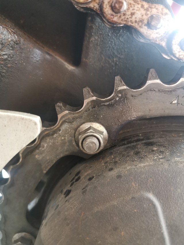

    The chain probably looks worse than what it is, it's got hard what looks like corrosion on the outside, internal each link 'rotates' freely, I'd prefer a gold chain but funds are tight since the purchase.

    A wee observation. Modern chains may be sealed with o rings to keep the grease in and the grit out BUT the external portion and rollers need some protection to minimise corrosion and sprocket wear. The rust specs on the chain sideplates suggest a little more lubricant is needed...... even just to protect from salt spray.
    Nice machine you have picked up there.

    Would you recommend changing the sprocket/chain after looking at the photo?

    It wouldn't hurt to put new chain and sprockets on, you don't know how the previous keeper(s) looked after it. Regarding the linkage bearings just raise the bike with a trolley jack or similar on the sidestand and remove the rear wheel. Take note (photos) of which way the linkage plates fit then remove the bolts, if you're lucky they will come out ok and the centre bush will just push out allowing you to slip a bit of grease in the roller bearings. Inspect the rubber seals and replace any duff ones while you are in there.

    Welcome CRC25. It’s hard to tell the extent of damage the rust has done to the chain by the photos. The sprocket looks fine, as it doesn’t show any significant wear. Take off the front sprocket cover and have a look at the sprocket, as the front usually wears quicker than the rear. If you need to replace the chain and both sprockets don’t show any wear, then just replace the chain, if not, it would be wise to replace all of it.

    for the extra few pounds I would replace chain and sprockets together. as just putting a new chain on is a false economy to me
