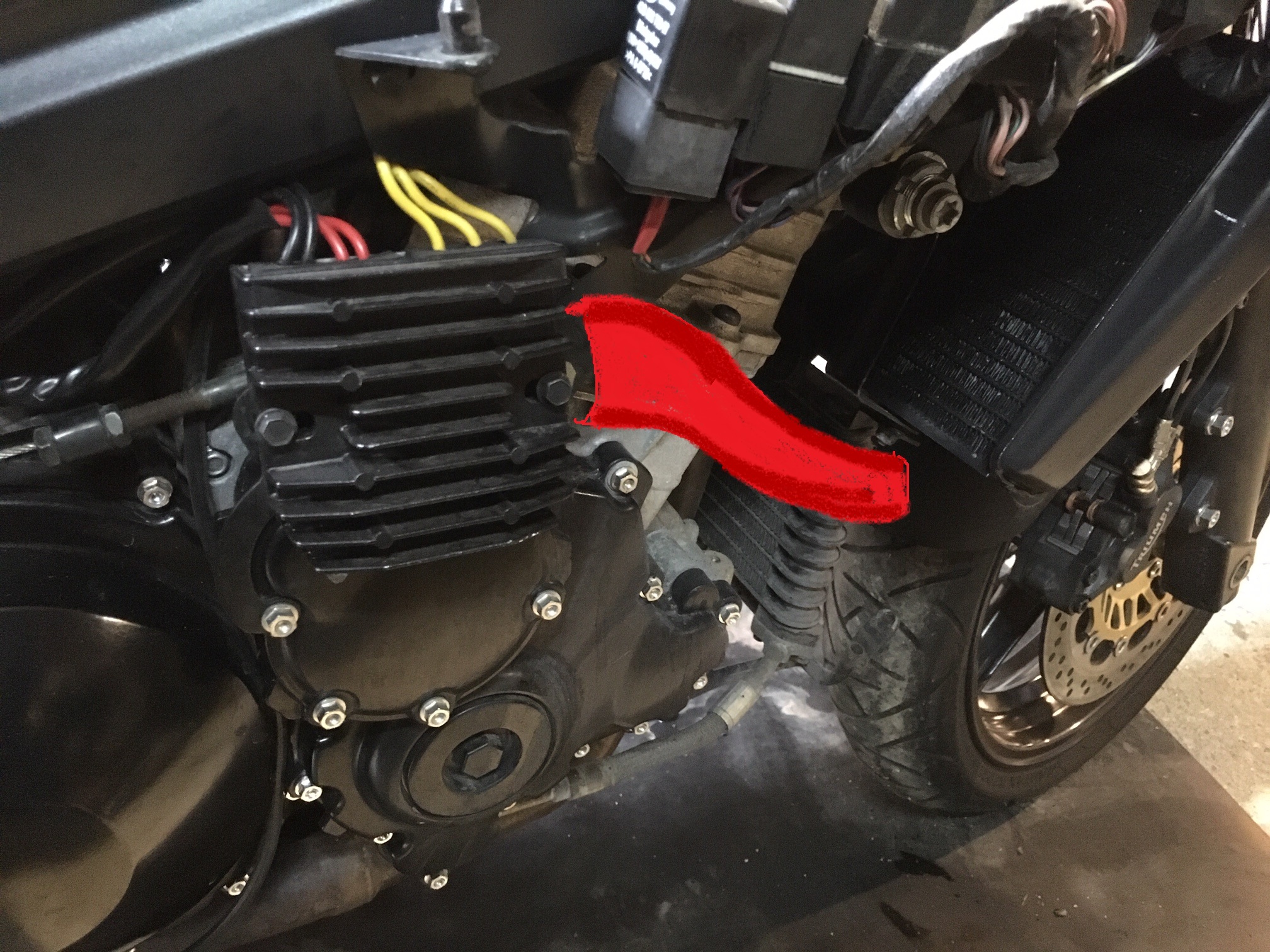

    At noon pause I've taken 5 minutes in front of the bike. A cooling hose could be placed from aside the oil radiator up to the regulator.
    I made a high level engineering plan with paint. Hope the bike makers lobby will not steal my idea.. :p

  10. Hubaxe
    Mar 25, 2020
    1,718
    Aix Les bains - French Alps
    That's exactly the case on my ST. My bike is a 2005, and I have the big black foam, probablys added afterward by a dealer. The reg is just behind the foam. My plan is to fix a flexible tube in the foam, and get fresh air in the front lower part of the fairing. If my plan is ok, this can be fixed on the right side panel without shadowing the vent. I need to find a flexible aluminium hose and try that.

  15. Hubaxe
    Mar 25, 2020
    1,718
    After considering putting a hose to cool the regulator, I've been to the conclusion the option of relocating the RR to the left side is easier. I'm about to follow your good and appreciated advices.
    I'm now trying to find some RR cable extension. I can probably build the bracket myself.
