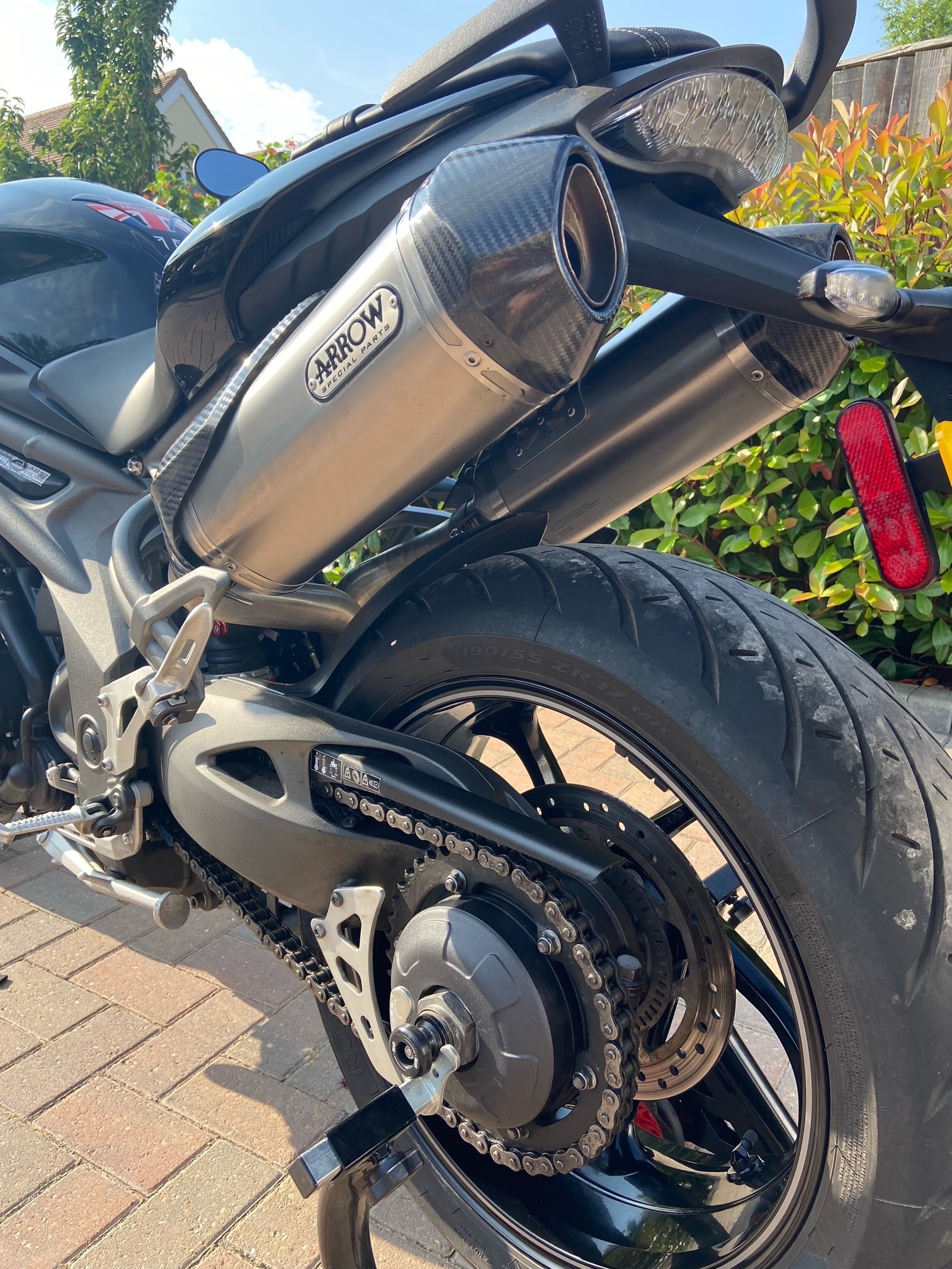

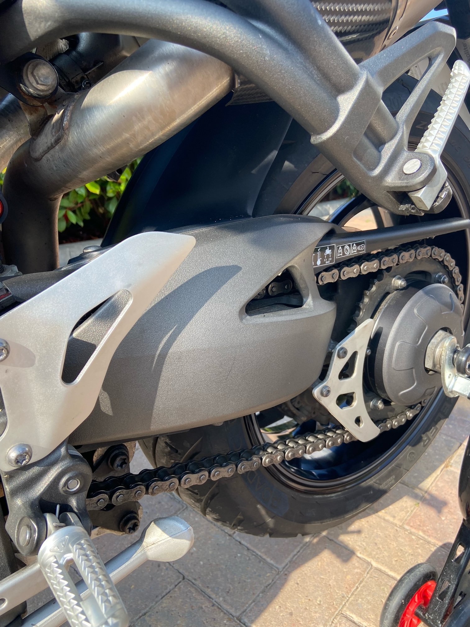

    I'd like to replace the standard chain guard on my 2019 S with a carbon fibre jobbie. However it looks impossible to get at the retaining bolt without removing the rear wheel. Am I right?
    TIA.
    Phil

    @English Phil What bike mate. And a picture of the area would be helpful. I have never had to remove wheel to get a chain guard of

    It's a 2019 Speed triple S. The bolt is cunningly hidden inside the swing arm!

    I would go for the Carbon FBR rear extended hugger and chain guard, the parts are top quality. As regards the removal of the chain guard it can be done in situ, however given the fastner is very hard to get at and time consuming, especially putting it back, it is far easier to just remove the rear wheel, it only takes a couple of minutes, and you wont risk damaging the torx head.
