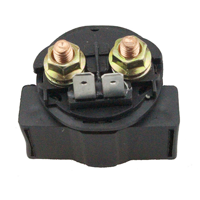

  12. Callumity
    Callumity Elite Member
    Feb 25, 2017
    3,358
    Nr Biggar
    A loud click when you press the starter is strongly suggestive of:
    Loose battery or solenoid terminal post connections.
    Defective starter motor (connections, worn brushes, etc),
    Or burned-out main contacts in solenoid.
    We are talking about this thing lurking under the side cover. It is just a hunky relay that uses a light current to switch to a heavy one.

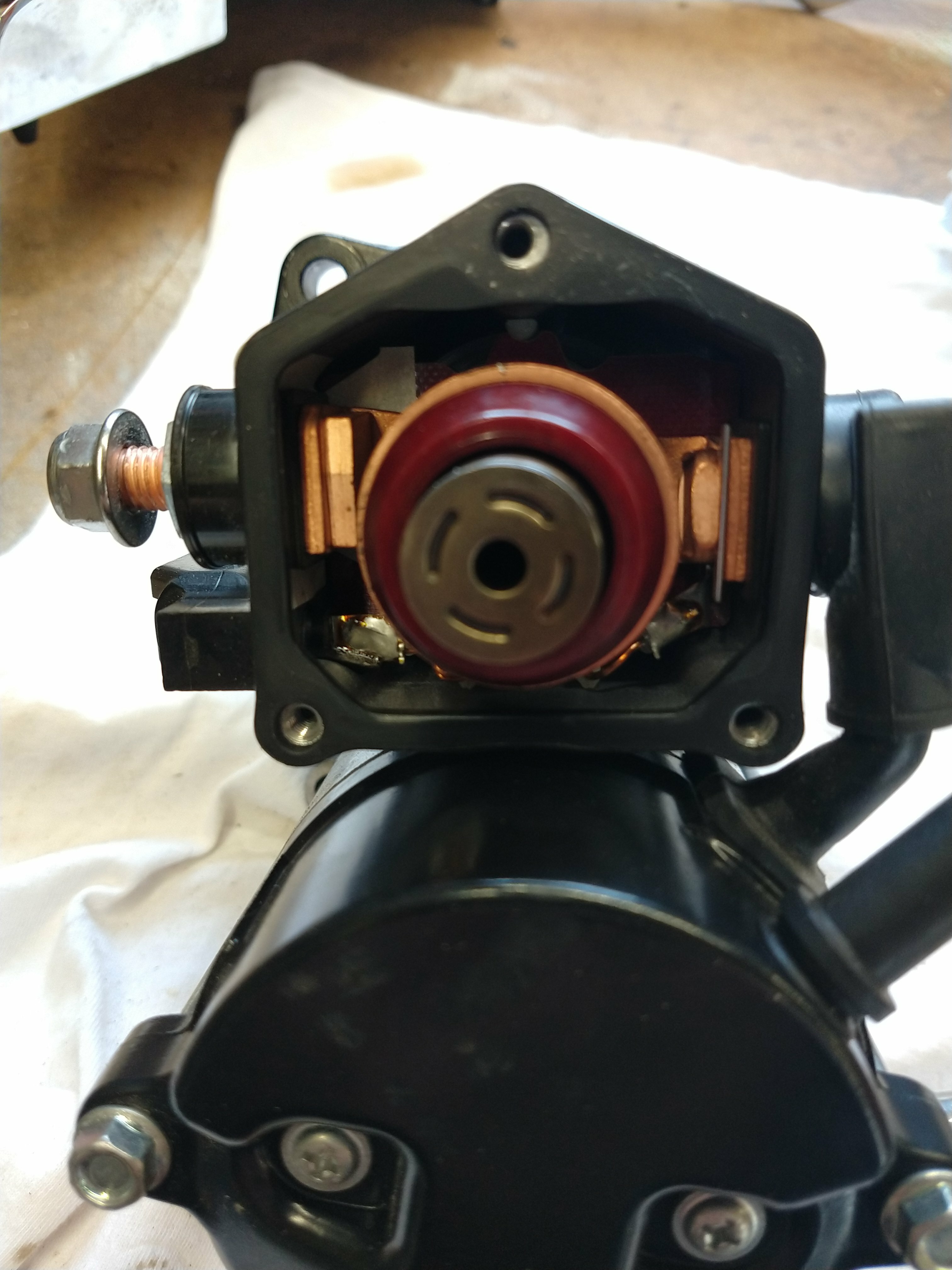

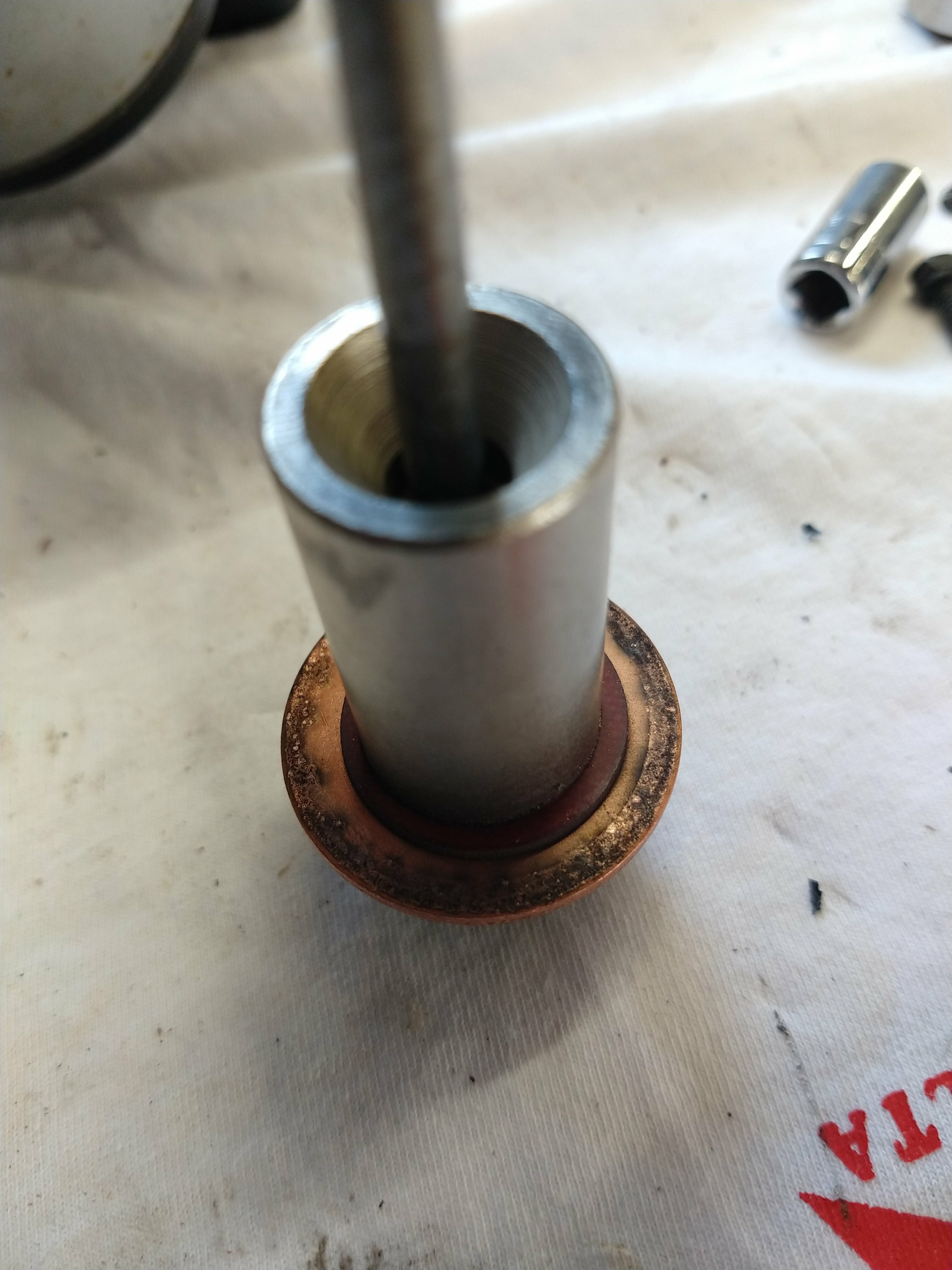

  13. Rod Stewart
    Rod Stewart Member
    Apr 14, 2019
    34
    Kinloss
    Hi again, I had a few hours today on the TBird, I removed the starter and checked it out on the bench I attached a few pics, everything looks ok the main solenoid contacts look not too bad a wee bit of pitting which I cleaned up, re-fitted the starter and got the same clunk, measuring the voltage to the starter from the solenoid when I pressed the start button showed no volts from solenoid output, I then energised the solenoid directly from the battery and the engine turned over.
    Now.. I think the solenoid is being energised but not holding in, aaarggg.
    what now back to double check the safety interlocks
  14. Callumity
    Feb 25, 2017
    3,358
    Nr Biggar
    #14 Callumity, Apr 18, 2019
    If it energises direct from the battery have you checked the starter button output feed? There is also potential for confusion between the solenoid/relay and the starter solenoid electro magnet that throws the bendix into mesh with the starter gear and makes motor electrical contact. You are playing with the latter. Have you checked the former?
