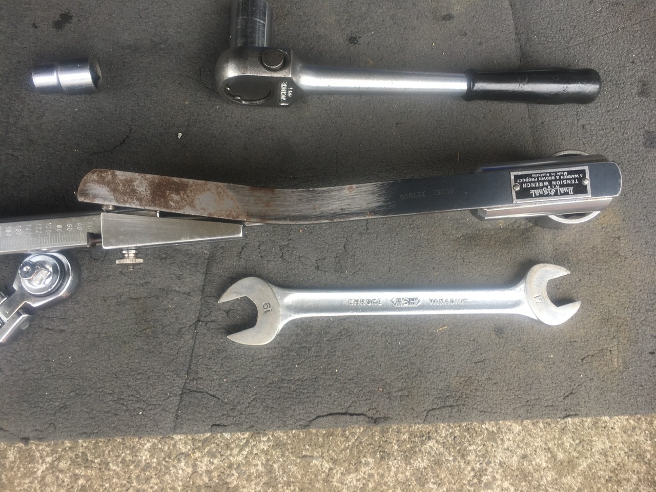

Tighten up left side
Lock the valve nut and tighten the valve down. You need to tighten the locking nuts to 20ftlbs...

Lock the valve nut and tighten the valve down. You need to tighten the locking nuts to 20ftlbs and then torque the valve head. Once all other items are replaced, set the compression and preadjust to 15 winds/clicks and then start the right side after removing the axel.
