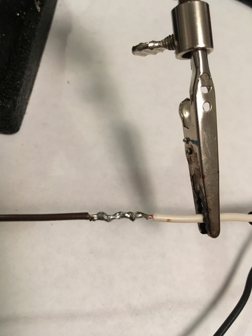

Step 29, I elected to solder the stock wires to the new LEDs. I cut off about half of the LED...

Step 29, I elected to solder the stock wires to the new LEDs. I cut off about half of the LED wires. This still left plenty of wire to work with. Brown LED wire is soldered to the white lead and black to black. Be sure to stagger connections and shrink wrap. Don't forget to slide on the final shrink wrap covering before starting soldering process. This method keeps the lead to the connectors tight so slipping the flange mounting nut back over easier.
